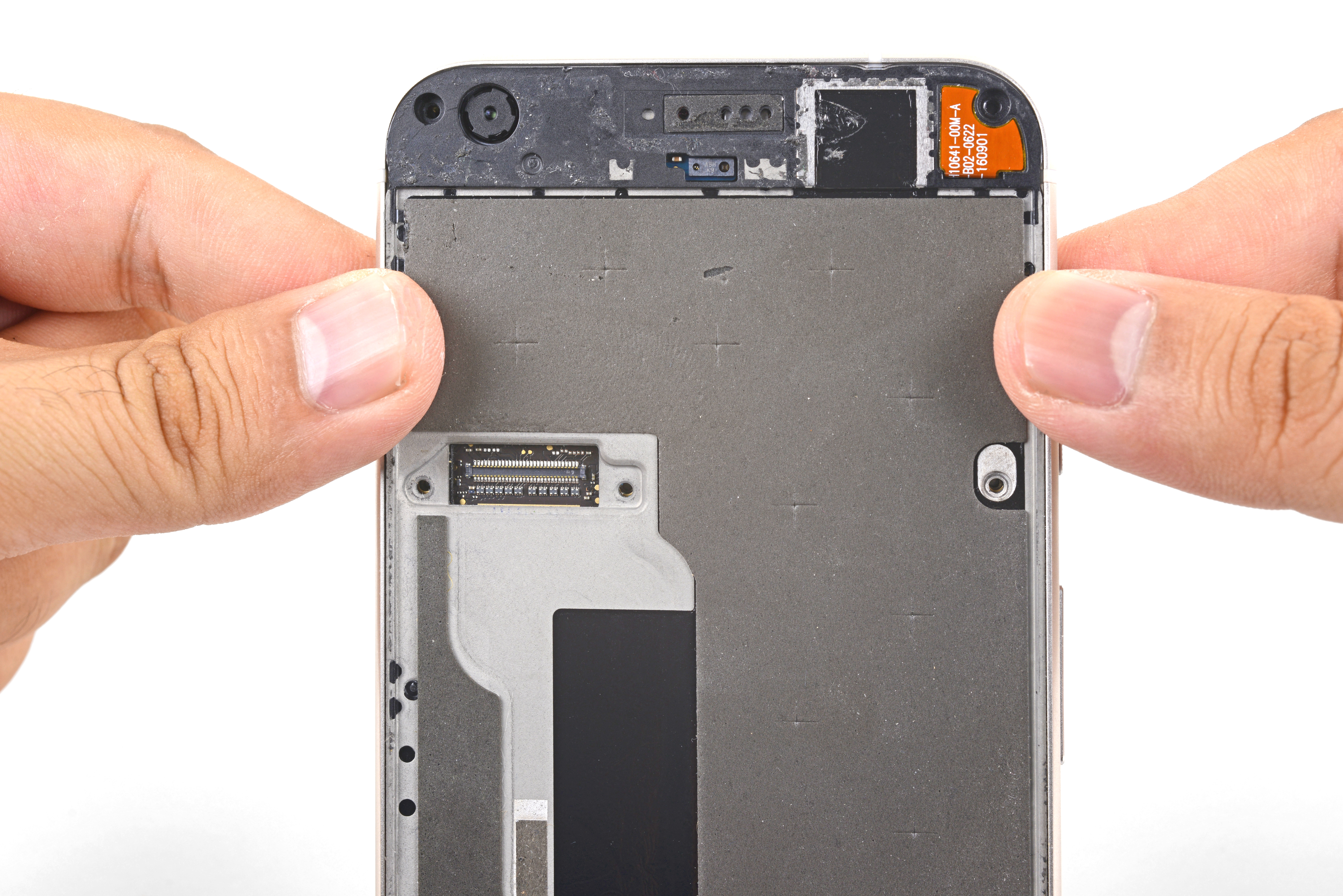

  6. Google Pixel XL Battery Replacement: 手順 6、 1の画像 1
    • Once you have sliced around the perimeter of the phone, carefully lift the display assembly up slightly by the right corners.
    • Do not attempt to remove the display assembly. It is still attached by a flex cable.
    • Use an opening pick to slice through any remaining adhesive.
