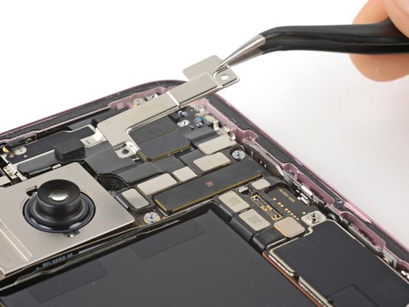

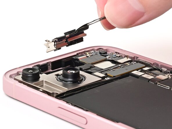

  20. iPhone 15 Logic Board Replacement, Remove the cover: 手順 20、 3の画像 1 iPhone 15 Logic Board Replacement, Remove the cover: 手順 20、 3の画像 2 iPhone 15 Logic Board Replacement, Remove the cover: 手順 20、 3の画像 3
    この手順で使用する道具:
    • Use tweezers to lift the cover to a 90-degree angle.
    • Unhook the cover from its slot in the logic board.
    • Remove the cover.

  47. iPhone 15 Logic Board Replacement, Remove the upper connector cover: 手順 47、 3の画像 1 iPhone 15 Logic Board Replacement, Remove the upper connector cover: 手順 47、 3の画像 2 iPhone 15 Logic Board Replacement, Remove the upper connector cover: 手順 47、 3の画像 3
    • Use your tri-point Y000 driver to remove the two 1.3 mm‑long screws securing the upper connector cover.
    • Remove the cover.

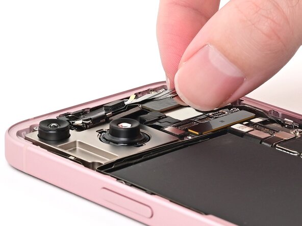

  48. iPhone 15 Logic Board Replacement, Disconnect the front camera and sensors: 手順 48、 3の画像 1 iPhone 15 Logic Board Replacement, Disconnect the front camera and sensors: 手順 48、 3の画像 2 iPhone 15 Logic Board Replacement, Disconnect the front camera and sensors: 手順 48、 3の画像 3
    • Use the tip of an opening pick to pry up and disconnect the antenna, front sensors, and front camera press connectors (three connectors in total).
  49. iPhone 15 Logic Board Replacement, Remove the front camera and sensors: 手順 49、 2の画像 1 iPhone 15 Logic Board Replacement, Remove the front camera and sensors: 手順 49、 2の画像 2
    この手順で使用する道具:
    • Use tweezers or your fingers to pull the front camera and sensors out of their recess in the frame and remove them.

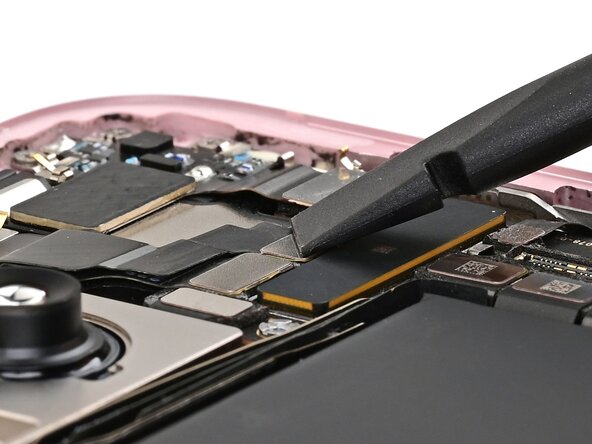

  53. iPhone 15 Logic Board Replacement, Separate the battery cable: 手順 53、 3の画像 1 iPhone 15 Logic Board Replacement, Separate the battery cable: 手順 53、 3の画像 2 iPhone 15 Logic Board Replacement, Separate the battery cable: 手順 53、 3の画像 3
    • Light adhesive secures the battery cable to the logic board.
    • Slide an opening pick under the battery cable to separate it from the logic board.
    • Be careful not to crease the cable or dent the battery with your tool.

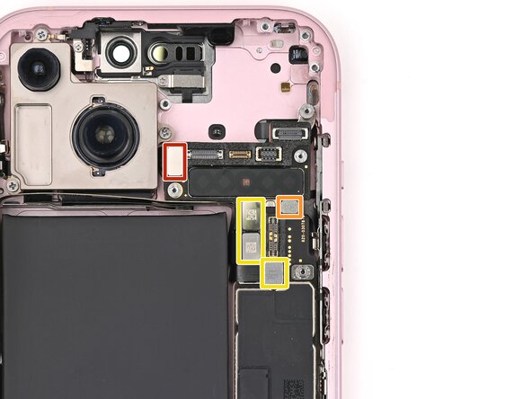

  57. iPhone 15 Logic Board Replacement, Disconnect the eSIM, Taptic Engine, and charging port: 手順 57、 3の画像 1 iPhone 15 Logic Board Replacement, Disconnect the eSIM, Taptic Engine, and charging port: 手順 57、 3の画像 2 iPhone 15 Logic Board Replacement, Disconnect the eSIM, Taptic Engine, and charging port: 手順 57、 3の画像 3
    • Disconnect the eSIM, Taptic Engine, and charging port press connectors (three connectors in total).

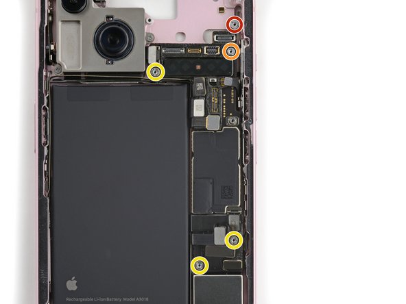

  58. iPhone 15 Logic Board Replacement, Unfasten the logic board: 手順 58、 2の画像 1 iPhone 15 Logic Board Replacement, Unfasten the logic board: 手順 58、 2の画像 2
    この手順で使用する道具:
    Standoff Screwdriver for iPhones
    $5.49
    • Use your standoff driver to remove the five standoff screws securing the logic board:
    • One 2.9 mm‑long screw
    • One 3.9 mm‑long screw
    • Three 3.5 mm‑long screws
    • If you don't have a standoff driver, you may use a thin flathead driver—but be careful not to strip the shallow notches in the screw heads.
