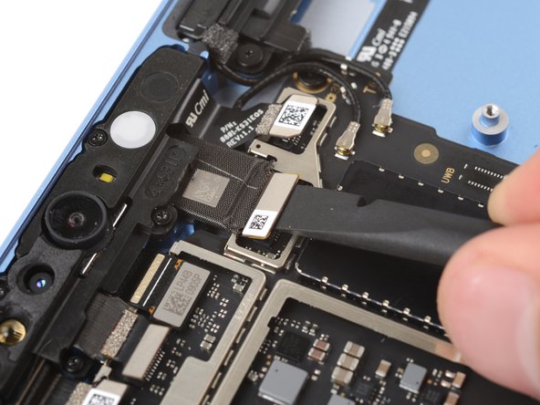

    4. Microsoft Surface Pro 11 Rear Camera Replacement: 手順 42、 3の画像 1 Microsoft Surface Pro 11 Rear Camera Replacement: 手順 42、 3の画像 2 Microsoft Surface Pro 11 Rear Camera Replacement: 手順 42、 3の画像 3
      • Use the flat end of a spudger to pry up and disconnect the Windows Hello sensor and rear camera press connectors.

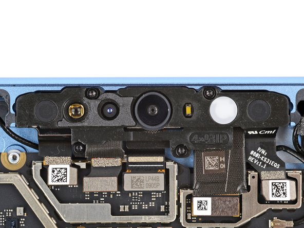

    6. Microsoft Surface Pro 11 Rear Camera Replacement, Remove the front sensor assembly screws: 手順 44、 2の画像 1 Microsoft Surface Pro 11 Rear Camera Replacement, Remove the front sensor assembly screws: 手順 44、 2の画像 2
      • Use a Torx Plus 3IP screwdriver to remove the four 3.3 mm‑long screws securing the front sensor assembly.

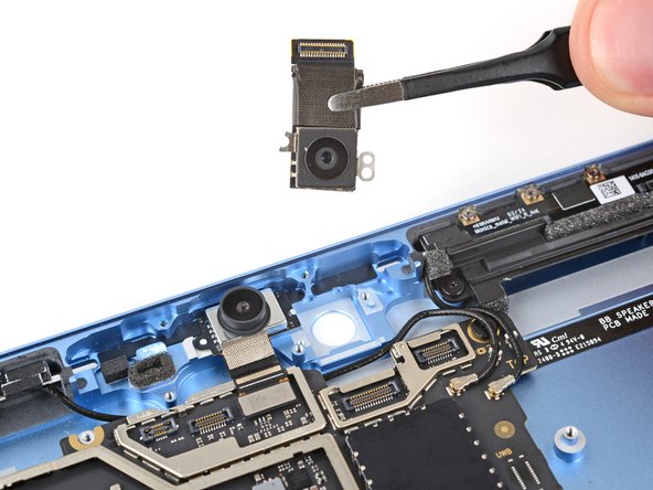

    7. Microsoft Surface Pro 11 Rear Camera Replacement, Remove the front sensor assembly: 手順 45、 2の画像 1 Microsoft Surface Pro 11 Rear Camera Replacement, Remove the front sensor assembly: 手順 45、 2の画像 2
      • Lift the front sensor assembly straight up and remove it.
