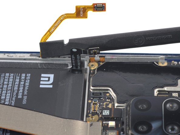

  13. Xiaomi Redmi Note 9S Battery Replacement, Disconnect the power and volume button cable: 手順 13、 3の画像 1 Xiaomi Redmi Note 9S Battery Replacement, Disconnect the power and volume button cable: 手順 13、 3の画像 2 Xiaomi Redmi Note 9S Battery Replacement, Disconnect the power and volume button cable: 手順 13、 3の画像 3
    • Use a spudger to disconnect the power and volume button cable by prying the connector straight up from its socket.
    • Use your spudger to carefully fold the power and volume button cable to the side to free the battery.
    • Don't fold the cable sharply and only bend it to avoid cable damage.

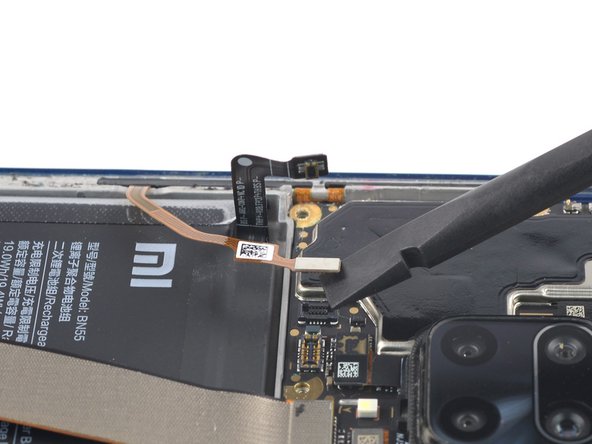

  14. Xiaomi Redmi Note 9S Battery Replacement, Disconnect the display cable: 手順 14、 2の画像 1 Xiaomi Redmi Note 9S Battery Replacement, Disconnect the display cable: 手順 14、 2の画像 2
    • Use a spudger to disconnect the display cable by prying the connector straight up from its socket.
  15. Xiaomi Redmi Note 9S Battery Replacement, Disconnect the motherboard interconnect cable: 手順 15、 2の画像 1 Xiaomi Redmi Note 9S Battery Replacement, Disconnect the motherboard interconnect cable: 手順 15、 2の画像 2
    • Use a spudger to disconnect the motherboard interconnect cable by prying the connector straight up from its socket.
