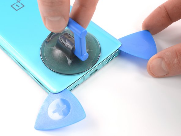

  3. OnePlus 8T Screen Replacement, Create a gap: 手順 3、 3の画像 1 OnePlus 8T Screen Replacement, Create a gap: 手順 3、 3の画像 2 OnePlus 8T Screen Replacement, Create a gap: 手順 3、 3の画像 3
    • Apply a suction cup to the back of the phone, as close as possible to the center of the bottom edge.
    • If the back cover is cracked, the suction handle may not stick. Try lifting it with strong tape, or superglue the suction handle in place and allow it to cure so you can proceed.
    • Pull on the suction cup to create a gap between the rear glass and the frame.
    • Insert the tip of an opening pick into the gap and slide it to the bottom left corner.
    • Leave the opening pick in its place to prevent the adhesive from resealing.

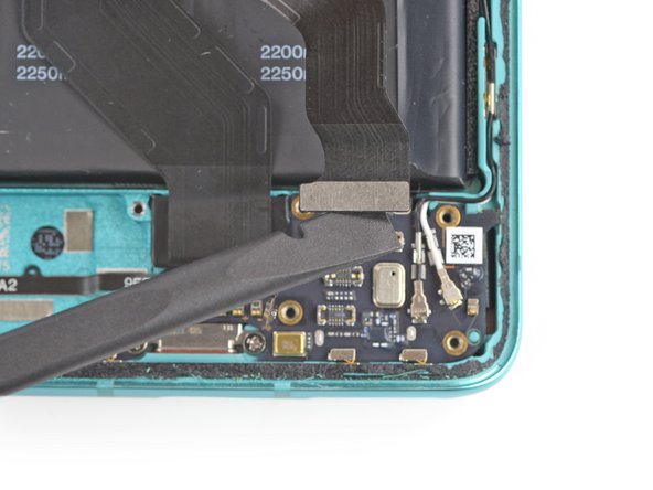

  15. OnePlus 8T Screen Replacement, Disconnect the fingerprint sensor: 手順 15、 2の画像 1 OnePlus 8T Screen Replacement, Disconnect the fingerprint sensor: 手順 15、 2の画像 2
    • Use a spudger to disconnect the first fingerprint sensor connector by prying it straight up from its socket.

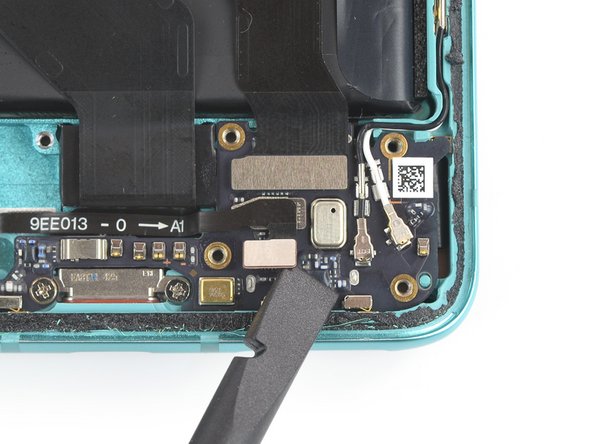

  18. OnePlus 8T Screen Replacement, Disconnect the antenna cables: 手順 18、 3の画像 1 OnePlus 8T Screen Replacement, Disconnect the antenna cables: 手順 18、 3の画像 2 OnePlus 8T Screen Replacement, Disconnect the antenna cables: 手順 18、 3の画像 3
    • Carefully disconnect the two antenna cables by prying them straight up from the daughterboard.

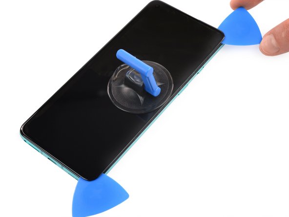

  23. OnePlus 8T Screen Replacement, Create a gap: 手順 23、 2の画像 1 OnePlus 8T Screen Replacement, Create a gap: 手順 23、 2の画像 2
    • Apply a suction cup to the right edge of the screen.
    • If the phone's screen is cracked, the suction handle may not stick. Try lifting it with strong tape, or superglue the suction handle in place and allow it to cure so you can proceed.
    • Pull the suction cup up with strong, steady force to create a gap.
    • Insert the point of an opening pick into the gap and slide it to the bottom right corner.

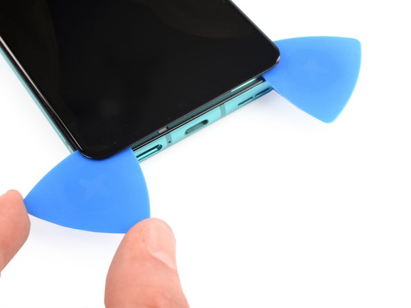

  24. OnePlus 8T Screen Replacement, Slice the adhesive: 手順 24、 3の画像 1 OnePlus 8T Screen Replacement, Slice the adhesive: 手順 24、 3の画像 2 OnePlus 8T Screen Replacement, Slice the adhesive: 手順 24、 3の画像 3
    • Insert a second opening pick at the bottom right corner.
    • Slide the opening pick along the right edge to the top right corner.
    • Leave both opening picks in their place to prevent the adhesive from resealing.
