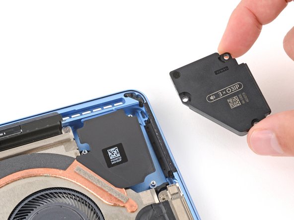

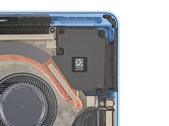

  25. Microsoft Surface Pro 11 Right Speaker Replacement, Remove the right speaker screws: 手順 25、 2の画像 1 Microsoft Surface Pro 11 Right Speaker Replacement, Remove the right speaker screws: 手順 25、 2の画像 2
    • Use a 3IP Torx Plus screwdriver to remove the three 2.6 mm‑long screws securing the right speaker.

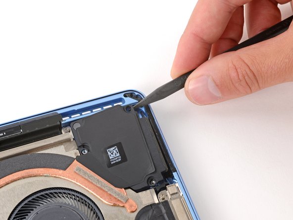

  26. Microsoft Surface Pro 11 Right Speaker Replacement, Remove the speaker: 手順 26、 3の画像 1 Microsoft Surface Pro 11 Right Speaker Replacement, Remove the speaker: 手順 26、 3の画像 2 Microsoft Surface Pro 11 Right Speaker Replacement, Remove the speaker: 手順 26、 3の画像 3
    • Be careful not to rip the piece of graphite film covering the right speaker.
    • Use a spudger to lift the right speaker enough that you can grip it with your fingers.
    • Lift and remove the speaker.
