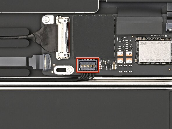

  8. MacBook Neo Battery Replacement, Disconnect the headphone jack and left speaker: 手順 8、 3の画像 1 MacBook Neo Battery Replacement, Disconnect the headphone jack and left speaker: 手順 8、 3の画像 2 MacBook Neo Battery Replacement, Disconnect the headphone jack and left speaker: 手順 8、 3の画像 3
    • Insert the point of a spudger beneath the headphone jack connector, located on the right side of the logic board directly above the battery, and pry it straight up to disconnect it.
    • Repeat to disconnect the left speaker connector, adjacent to the headphone jack connector.

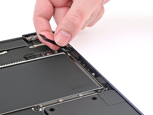

  10. MacBook Neo Battery Replacement, Free the right speaker cable: 手順 10、 3の画像 1 MacBook Neo Battery Replacement, Free the right speaker cable: 手順 10、 3の画像 2 MacBook Neo Battery Replacement, Free the right speaker cable: 手順 10、 3の画像 3
    • Gently lift the right speaker cable out of its channel around the battery.

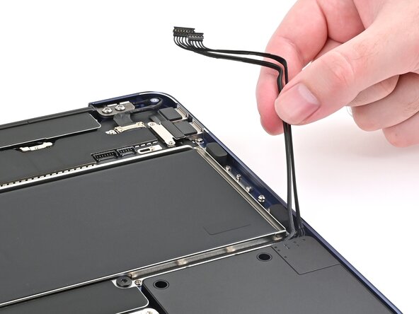

  11. MacBook Neo Battery Replacement, Free the left speaker cable: 手順 11、 3の画像 1 MacBook Neo Battery Replacement, Free the left speaker cable: 手順 11、 3の画像 2 MacBook Neo Battery Replacement, Free the left speaker cable: 手順 11、 3の画像 3
    • Repeat this procedure to free the left speaker cable.

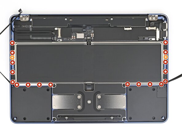

  13. MacBook Neo Battery Replacement, Remove the battery screws: 手順 13、 1の画像 1
    • Ensure the cables freed from around the battery are out of the way of the screws securing it.
    • Use a Torx Plus 5IP driver to remove the eighteen 2.8 mm‑long screws securing the battery.
    • Don't remove the two 3IP screws marked in yellow.
    • During reassembly, install the screws on the top‑left and bottom‑right corners of the battery first to align it. Then, install the remaining screws.
