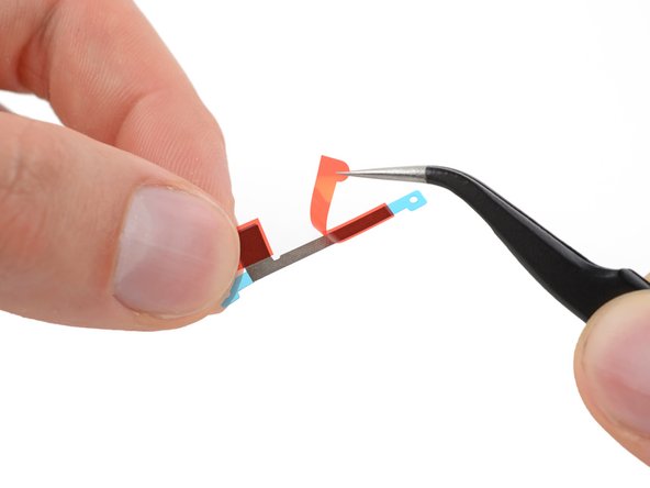

  13. Google Pixel 8a 5G mmWave Antenna Replacement, Separate the flash unit: 手順 13、 2の画像 1 Google Pixel 8a 5G mmWave Antenna Replacement, Separate the flash unit: 手順 13、 2の画像 2
    • Use a hair dryer to heat the flash unit to soften the adhesive securing it to the logic board cover.
    • Alternatively, you can use an iOpener or heat gun to warm the flash.
    • Only heat the flash so it's warm to the touch. The battery and surrounding components are susceptible to heat damage.

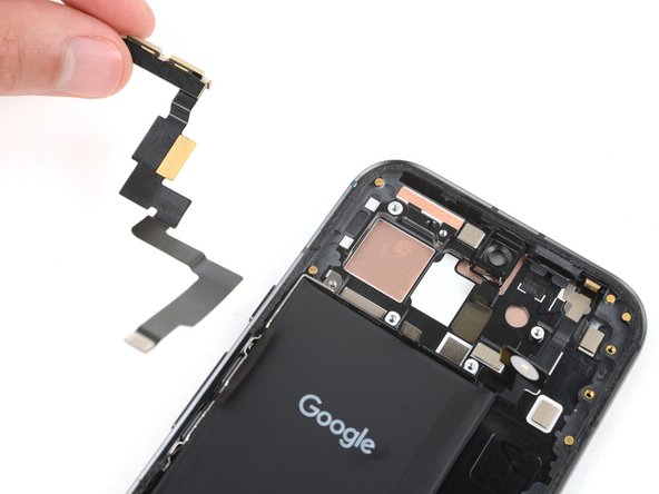

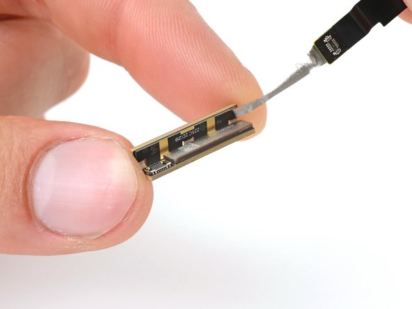

  21. Google Pixel 8a 5G mmWave Antenna Replacement, Disconnect the 5G mmWave antenna: 手順 21、 2の画像 1 Google Pixel 8a 5G mmWave Antenna Replacement, Disconnect the 5G mmWave antenna: 手順 21、 2の画像 2
    • Insert the point of a spudger under the bottom edge of the 5G mmWave antenna press connector and pry straight up to disconnect it.
    FixBotに聞いてみる

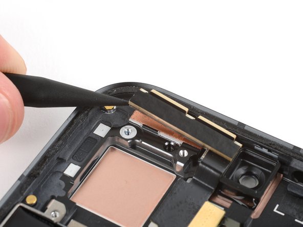

  25. Google Pixel 8a 5G mmWave Antenna Replacement: 手順 25、 3の画像 1 Google Pixel 8a 5G mmWave Antenna Replacement: 手順 25、 3の画像 2 Google Pixel 8a 5G mmWave Antenna Replacement: 手順 25、 3の画像 3
    • Insert an opening pick under the left edge of the antenna housing and pry up to release the clips securing the housing.
    • Repeat the process on the top edge to release the remaining clips.
    • During reassembly, press firmly around the perimeter of the housing to engage its clips.
    FixBotに聞いてみる

    • Move the battery and 5G mmWave cables out of the way of the battery.
    FixBotに聞いてみる
    コメントを追加

  38. Google Pixel 8a 5G mmWave Antenna Replacement, Remove the mmWave antenna: 手順 38、 2の画像 1 Google Pixel 8a 5G mmWave Antenna Replacement, Remove the mmWave antenna: 手順 38、 2の画像 2
    • The 5G mmWave antenna is lightly adhered to the frame.
    • Insert the point of your spudger under the lower left corner of the 5G mmWave antenna and pry up to separate its adhesive.

  39. Google Pixel 8a 5G mmWave Antenna Replacement: 手順 39、 2の画像 1 Google Pixel 8a 5G mmWave Antenna Replacement: 手順 39、 2の画像 2
    • Remove the 5G mmWave antenna and cable from the frame.

  40. Google Pixel 8a 5G mmWave Antenna Replacement, Remove the 5G mmWave antenna cable: 手順 40、 3の画像 1 Google Pixel 8a 5G mmWave Antenna Replacement, Remove the 5G mmWave antenna cable: 手順 40、 3の画像 2 Google Pixel 8a 5G mmWave Antenna Replacement, Remove the 5G mmWave antenna cable: 手順 40、 3の画像 3
    • Conductive tape secures the 5G mmWave antenna to its cable. In this step, you'll disconnect the cable before peeling off the tape.
    • Grab the cable as close to the head of the connector as possible and pry the connector away from the antenna to disconnect it.
    • Lift the 5G mmWave antenna cable upward and peel it from the antenna.
    • If the conductive tape rips, peel the remaining pieces off with tweezers or your fingers.

  42. Google Pixel 8a 5G mmWave Antenna Replacement, Prepare your 5G mmWave antenna for reassembly: 手順 42、 3の画像 1 Google Pixel 8a 5G mmWave Antenna Replacement, Prepare your 5G mmWave antenna for reassembly: 手順 42、 3の画像 2 Google Pixel 8a 5G mmWave Antenna Replacement, Prepare your 5G mmWave antenna for reassembly: 手順 42、 3の画像 3
    • The next three steps show how to reconnect the 5G mmWave antenna cable and apply new adhesive. If you don't have replacement adhesive, skip the remaining steps.
    • Peel your replacement adhesive off of the large liner.
    • Remove the two red liners to expose the sticky side of the adhesive.
