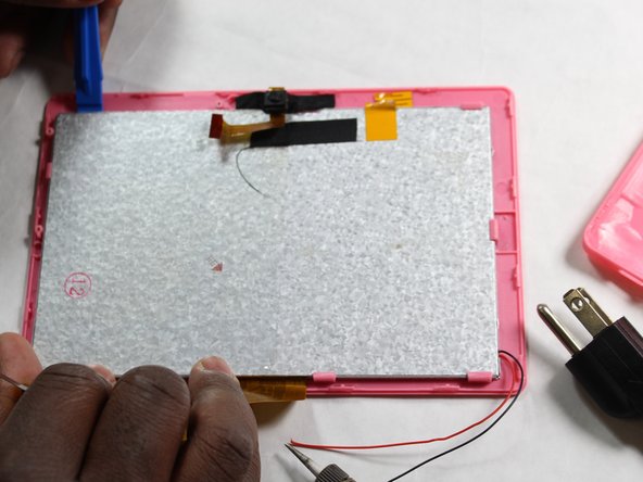

      • Power off the device and keep it unplugged.
      • Open the case using a plastic opening tool around the edges. Slightly pull the cover off.
      • Do not completely remove back casing because there is a speaker attached to the back.

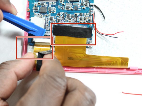

      • Disconnect the two ribbon cables between the screen and the motherboard.
      • Be careful not to rip out the ribbon cables or you can harm the ports.

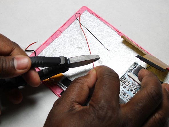

    4. Zeepad 7.0 Screen Replacement: 手順 4、 1の画像 1
      • Cut the power cables connecting between the screen and the motherboard. There should be a red and black cable each.

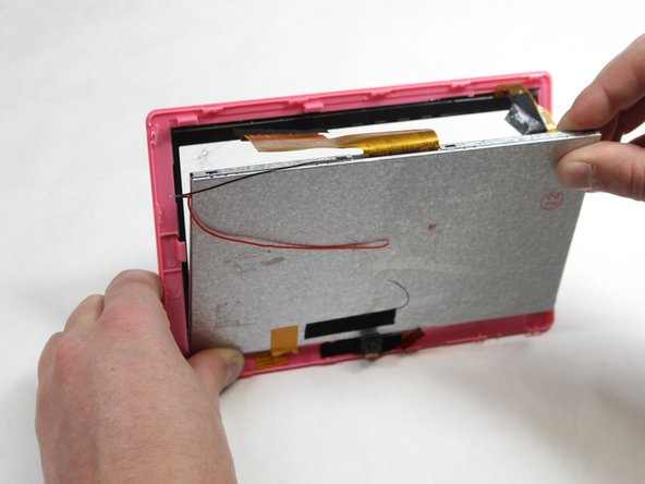

      • Separate the front screen protector from the lcd screen. There are clamps holding the screen in place.

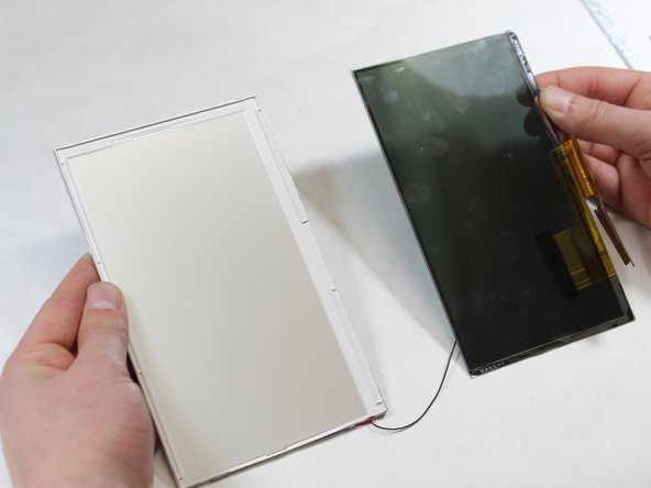

      • Separate the LCD screen from the metal protecting case with the metal spudger.

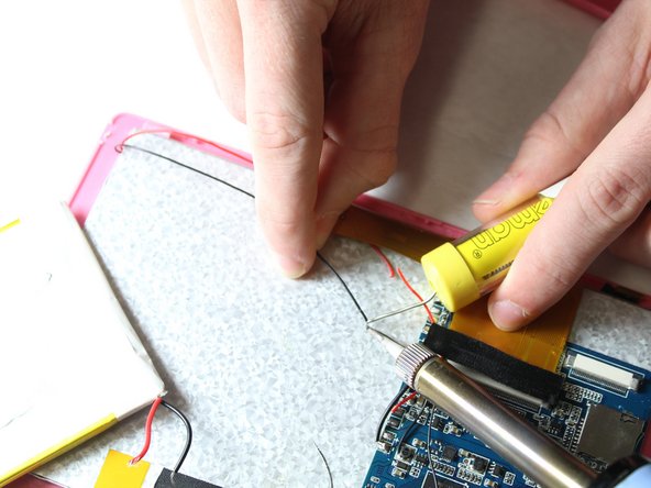

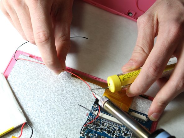

      • After creating space to work, warm up a soldering iron.
      • Apply heat onto the solder over the corresponding cut wires to the new screen wires.
      • はんだ付けとはんだ除去の作業ガイド
      • The soldering iron will be extremely hot. Keep out of direct contact to other wires, the motherboard, and especially the battery.
      • Keep out of reach of children.
