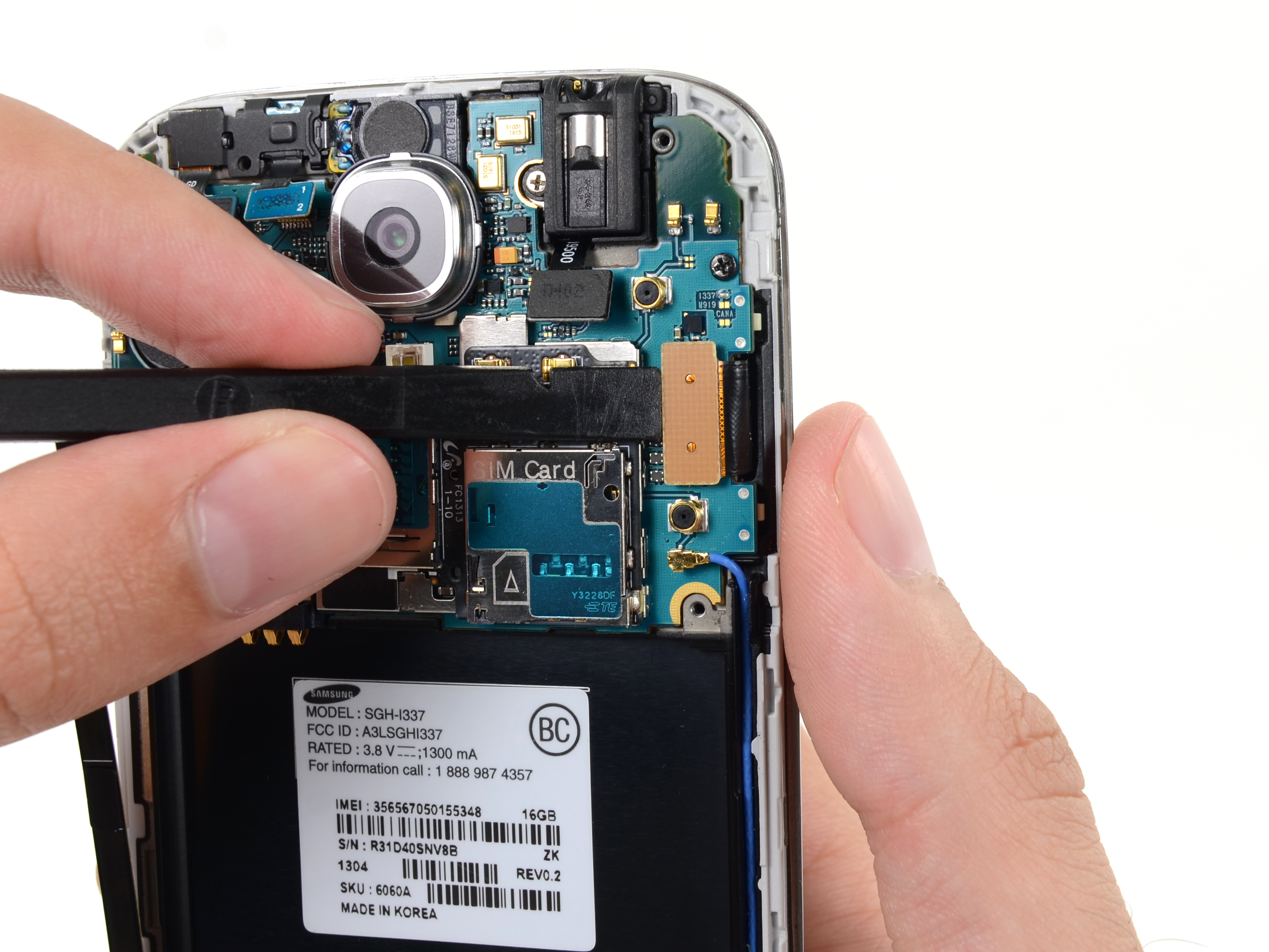

  3. Samsung Galaxy S4 Bare Screen Replacement, MicroSD Card: 手順 3、 3の画像 1 Samsung Galaxy S4 Bare Screen Replacement, MicroSD Card: 手順 3、 3の画像 2 Samsung Galaxy S4 Bare Screen Replacement, MicroSD Card: 手順 3、 3の画像 3
    • Use the flat end of a spudger, or your fingernail, to press the microSD card slightly deeper into its slot until you hear a click.
    • After the click, release the card and it will pop out of its slot.
    • Remove the microSD card.
    • For reassembly, push the microSD card into the slot until it clicks in place.
