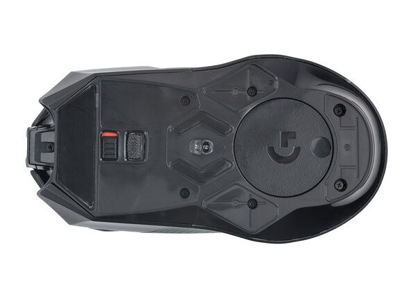

  1. How to Open the Logitech G903, Turn off the mouse: 手順 1、 2の画像 1 How to Open the Logitech G903, Turn off the mouse: 手順 1、 2の画像 2
    • Before you begin, flip the mouse's power switch to the OFF position.
    • A red indicator should be visible beneath the switch.
    • Unplug all cables from the mouse.
    • Throughout the repair, it may be helpful to lay the mouse on a soft cloth to stabilize it and prevent damage while you work.

  8. How to Open the Logitech G903, Remove the case screws: 手順 8、 2の画像 1 How to Open the Logitech G903, Remove the case screws: 手順 8、 2の画像 2
    • Use a Phillips screwdriver to remove the seven 4.5 mm‑long screws securing the two halves of the mouse together.
    • On older models, the top middle screw may be a Torx T5.
