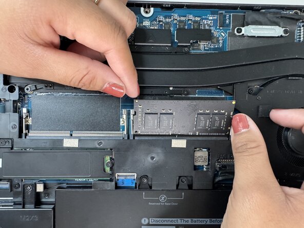

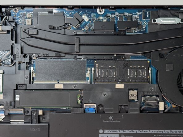

    • Locate RAM for removal Once looking at the interior of the underbody, you can locate the RAM(s) which will be in the high center of the device.
    • There should be two, which will be rectangular components, each about 2.7 inches in length. They will be located next to each other, with silver bars on each side of both, holding them in place.
    FixBotに聞いてみる
    コメントを追加
  3. Dell Precision 3541 RAM Replacement: 手順 3、 3の画像 1 Dell Precision 3541 RAM Replacement: 手順 3、 3の画像 2 Dell Precision 3541 RAM Replacement: 手順 3、 3の画像 3
    • Use the silver claps to remove the RAM (Use the silver claps to remove the RAM(s)) To remove one, or both, of the RAMs, you will use the silver bar-like clasps which are holding them in place.
    • To remove the RAM, simultaneously press both bars on each side outward and down, which allows the component to pop out of its holding.
    • Repeat to second RAM if desired.
