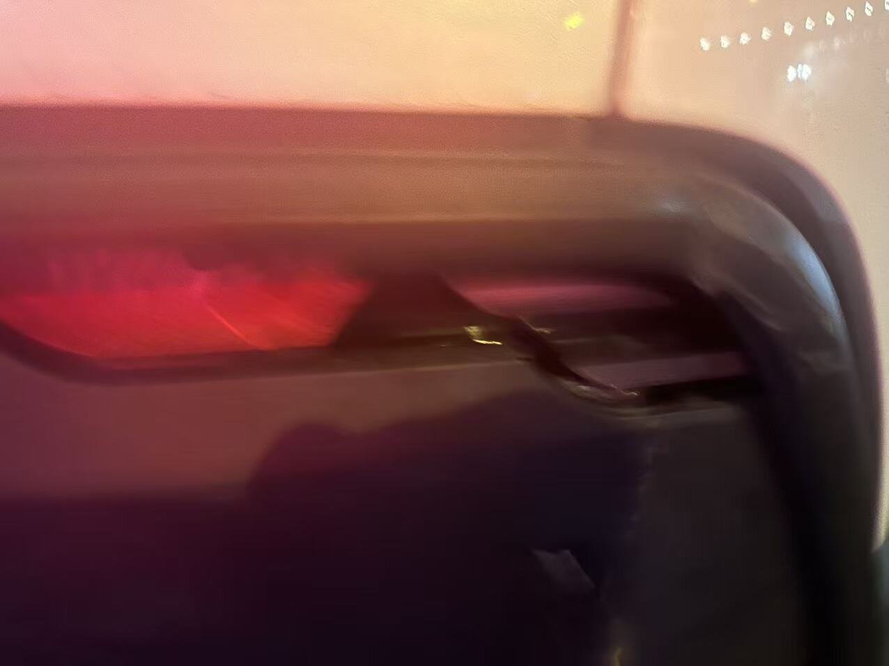

Rear Bumper Reflector damaged
new model Y
I accidentally damage the reflector. The led lights are working okay no problem it just the cover

Can I just got the cover to replace it or do I have to change the whole units

First, the good news: on most cars a rear bumper reflector is a small, self-contained piece, not a reason to replace the whole bumper. The question is whether the damage is limited to the reflector itself, or whether the bumper it mounts into is damaged too — and that decides whether this is a 20-minute trim job or a body-shop job.
Figure out what you're actually dealing with. A rear bumper reflector is usually a passive reflector — no bulb, no wiring — just a red lens in a housing that clips into the bumper cover. Check yours before you order: look at the back of it from underneath the bumper if you can see it, and check whether any wiring runs to it. If there's no wiring, it's a straight swap. If yours is wired (some versions tie into the rear lighting), don't just pull it — disconnect it properly and note the connector position before you remove it. Also check the lens versus the housing: a cracked lens alone is a reflector swap; a housing that's pushed in, or a bumper cover that's cracked or dented around the reflector opening, is a different problem.
Don't pry it out from the outside. This is the mistake that turns a reflector job into a bumper-cover job. Rear reflectors are almost always removed from behind: the bumper cover's inner side, or through the wheel-well liner, has the clips or screws that hold the reflector in. Prying from the outside with a trim tool or screwdriver cracks the lens further, scratches the paint around the opening, and can snap the mounting tabs on the bumper cover itself. The right approach is to get access from behind — on many cars that means loosening the rear wheel-well liner or reaching up from underneath — squeeze or unscrew the retaining clips, and push the reflector out from the back. If you can't get a hand behind it without dropping the bumper cover, that's normal on some cars: loosening the cover's lower fasteners to tilt it out slightly is still better than prying from the front.
Check the mounting points before you fit the new one. This is the step people skip, and it's why a new reflector sometimes pops straight back out. With the old reflector out, look at the opening in the bumper cover: the tabs or slots the reflector clips into should be intact and not cracked or stretched. If a tab on the bumper is broken, a new reflector won't stay in no matter how good it is — that's a bumper repair or replacement conversation, not a reflector problem. Also check the area around the opening for cracks in the paint or cover, and check that any nearby parking sensors are still seated flush — a hit hard enough to damage a reflector can knock a sensor out of alignment even if the sensor still looks fine.
Fitting the new reflector. Seat it from behind, the reverse of removal, and make sure every clip clicks in — a reflector held by one clip will rattle loose over bumps. Once it's in, check it from outside: flush with the bumper surface all the way around, no gap on one side, and no movement when you press it gently. A replacement rear bumper reflector commonly fits your Model Y, but always confirm against your vehicle's exact trim and engine and the product's fitment data before buying, since reflector shape and mounting vary by year and trim. If the bumper cover itself is cracked around the opening, the tabs are broken, or sensors in the bumper were disturbed, don't force the new reflector in and hope — that's the point to get a body shop to look at it — if unsure, consult a professional mechanic.
