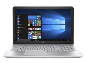

replacing key in keyboard
HP Pavilion 15-CW0505sa
H key will depress but will not display on screen
Need to know how to disassemble laptop to access keyboard
Any information would be appreciated

The laptop keys are removable. If it is just one key it will probably be dirt got under the key. Try to pop off the key with your finger but be aware of the plastic clips. clean the area and snap it back down. If the whole key board is bad, it can be replaced but you will need to open the back and disconnect some cables and screws and put in a new key board.
