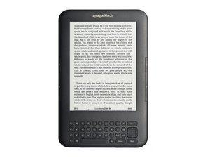

Part number and source for display?
Anyone
a) know the part number for the display
or
b) know a good source that doesn't charge $150 to steal my money via western union?
Been looking all over and you'd think with it being such a popular product there'd be a demand.

[Newer post, Mar 23 2013]
The displays are getting cheaper now. I found one for US$ 41,00 with free shipping.
Search in Ali Express for either Kindle 3 or Kindle keyboard or directly for the display’s part number ED060SC7(LF)
For instance, check this link:
Original PVI ED060SC7(LF) e-ink screen for Amazon Kindle3
Hope it helps.
Rgds,
Miguel Luiz
[First post, Jan 15 2012]
Try at AliExpress.com. Search for "Kindle Display". They sell it from US$ 60 to US$ 120 each (P/N ED060SC7):
http://www.aliexpress.com/product-fm/517...
I bought one myself and changed it - my Kindle is back to life again...
Rgds,
Miguel L.

They don't sell the part but they repair it for you here.
If you don't have the 3G model, I honestly don't think its even worth it.
EDIT: What I can think of is buying a broken as-is kindle off of ebay (With a working display) then use that and switch em. Here are some that look like they'd be up for a frankenstein-ing

Here is a cheaper source for replacing your kindle 3: http://www.mylcdtouchscreen.com/amazon-k...
I ordered one for my cracked kindle 3 screen, thanks to the guides on youtube the replacement was not very hard, took around half an hour, now my kinlde working like new again.
