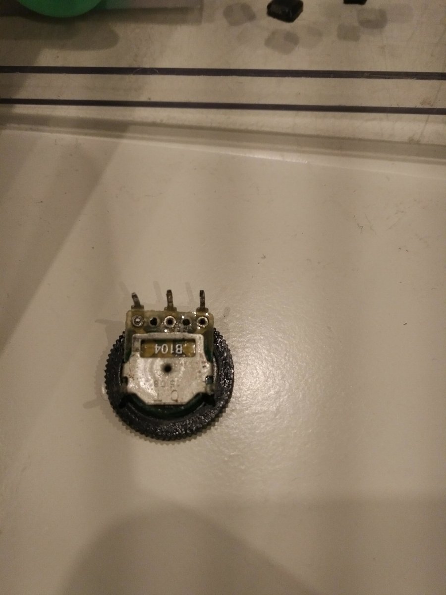

Here is the part I was able to get out. Where can I find the replacement

I have this issue with my 420x and after some research the only fix i could find would be to replace the volume potentiometer but that requires taking the headset apart and soldering a new one in, no problem for me, but where does one find the super slim potentiometers used in these headsets?
このアンサーは役に立ちましたか?
スコア 0
9 件のコメント:
Take the potentiometer out, get the part number off from it, eBay the part number... Solved. Solder new one on when it arrives.
さんによる
I have takent the part off the TB stealth 500p, here are the markings
CT1508
B104
now I have to try to find the potentionmeter to replace it
さんによる
I think its a 16mm x2mm dial
さんによる
I haven't had much luck. I finally got the 16x2 B104 which are 100k resistor potentionmeters and the sound is too faint.
not sure if there is another issue or not but I think I will abandon this project.
さんによる
BTW I have extra potentiometers 16x2mm T104 if anyone wants a couple. I had to buy in bulk. Just pay a couple$ for shipping
さんによる
