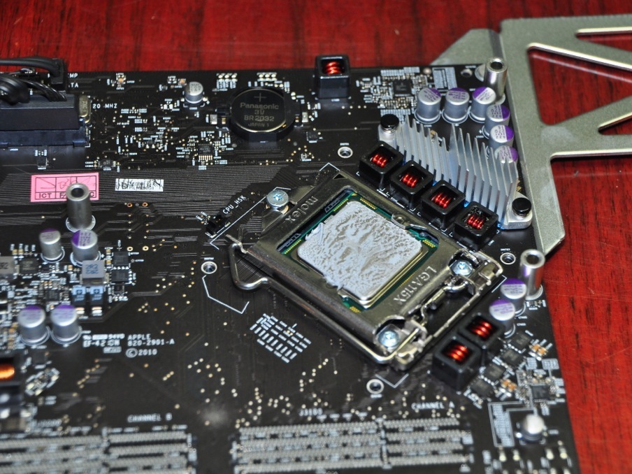

How do I access and replace my PRAM battery?
I can't fine a video on how to access or change out my PRAM battery. My iMac i5 mid 2010 27 inch (EMC 2390) keeps shutting down on its own and I want to fix it. Im looking for a cheap solution before I have to replace the power supply.

Hey guys,
I thank all of you for your replies! Come to find out I just needed to reset my PRAM. I googled how to do that and it has been running fine for over 24 hours now! WooHoo! Now I need to trouble shoot my Ethernet port on the same machine. It doest recognize a cable plugged in. When I go to the network setting it looks like its trying but still says cable unplugged. I think it may have gotten fried. I don't want to spend the money on a new logic board. The Wi'Fi still works. Thanks again !

Yes you can, you will need to dissasemble the entire imac, it is in the back of the logic board, close to the ram slots. Coin battery model in most computers PRAM is BR 2032, not CR 2032, the first has better support for high temperatures and different composition aldough both have same volts and amperes.

Sadly, we don't have a guide or video for replacing the battery.
The battery is located on the back side of the logic board. You can see it here: Back side of logic board The Battery is on the top edge (Panasonic BR2032)
