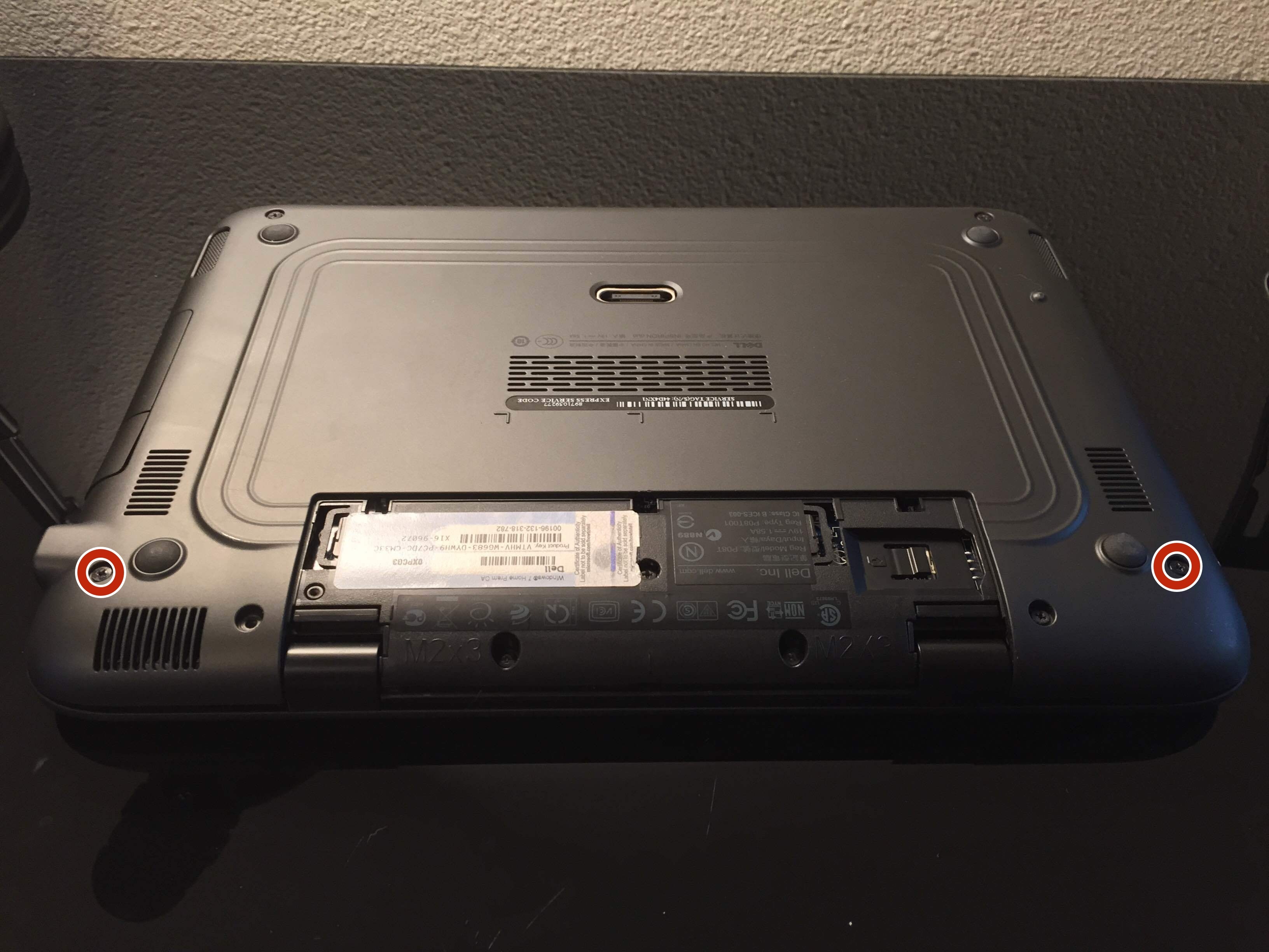

How do I replace the keyboard?
There are quite a few keys not working on my keyboard. There are no sticky or dirty keys, I think it's just getting old. I'd like to replace it, but am unsure how to remove it.

To remove the keyboard, remove the two screws that are closest to the power button and power adapter port on the bottom of the device, where the dock port is located. Open up the device, and you will be able to lift up the keyboard from the top near the F1-F12 keys. You'll need to disconnect the long, black ribbon cable by gently lifting on the black plastic ribbon cable clamp. Be careful, they're easy to break! To install a new keyboard, you can follow these steps in reverse.
