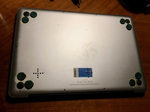

MacBook Pro 2011 GPU Glitch
Hi iFixit!
Thanks for the great site. I have fixed and repaired a lot of stuff using your guides. Clear and easy to follow!
Do you have any solutions to the wide spread MacBook Pro 2011 GPU Glitch?
http://action.mbp2011.com/
We are a lot of affected user that would love to get our MBP's up and running again.
Are there any hardware repairs or replacement one can do?
Here's a hack that sounds plausible but havent tried myself:
http://www.asyncro.com/2014/03/24/macboo...
Facebook group:
https://www.facebook.com/groups/2011mbp/
Thanks again iFixit would love to hear your feedback! Apple remains silent.

This Article I found made mi MBP2011 boot again using only the i7 Intel HD3000!!! No Safe Mode 256 colors and slow graphic $@$*!& issues. This MBP was repaired under the Apple Extension Repair plan in 2015 and failed again in 2018. Please Spread this fix to all users you know with this issue... It really works (until now... its been almos two months since I tried this) It saves you a lot of frustration!!!
https://apple.stackexchange.com/question...
Background and explanations
All MacBook Pros from 2011 have a serious design defect. The thermal management and the generated heat together with the robustness of the discrete AMD graphics chips do not match up very well. Apple knew this and acted like a typical Soapy Smith, only reacting to this after an outrage. This scandal took on the name of RadeonGate. Only with a threatened class-action law suit Apple was finally pressured into offering a so called "Repair Extension Program".
The Apple Repair Extension program is not available anymore. The only real way to fix this problem is to replace the AMD chip alone. Not the logic board. Not "re-balling", not "reflowing", not "baking". Apple replaced a failed chip with a failing chip. Time and time again. Only replacing the graphics chip is still a costly hardware procedure for such a vintage laptop.
The only known way – that is: with software alone – to get a 2011 MacBook Pro (8,2) with 'only' a failed AMD graphics chip to almost reliably turn on again and boot into macOS and be quite useable with an accelerated GUI is this guide or a variation of it. Most previous tips just removed all AMD-kexts and this results in a horrible user experience with no GUI acceleration at all.
It is necessary to know your exact OS version. The following guide will be simpler for Yosemite but assumes El Capitan or newer. El Capitan, Sierra and High Sierra need SIP (System Integrity Protection) disabled. On previous systems (10.6–10.10) these steps are unnecessary.
Important: This guide assumes further that all kexts are still in their default location /System/Library/Extensions. Having all AMD-kexts there except one is beneficial for 'proper' operation. Previous hacks in this direction might have instructed you to move, or worse: remove all AMD*/ATI* kernel extensions. If that is the case: either move the kexts back into their default location or reinstall a system of your choice. Having most of the AMD kexts in place and then having the X3000-kext loaded with a delay will enable power management of the GPU which will otherwise burn electricity for nothing (and might hasten the final heat death of the chip on top of that). To reiterate: Only the file AMDRadeonX3000.kext really has be absent on boot to enable a successful startup, but all other (needed) AMD drivers should be in their default location and the X3000-kext loaded afterwards/delayed to get back into a realm of almost sensible power and temperature management.
Bypassing the discrete graphics chip
To get some display acceleration back it will be necessary to force the machine to not boot in discrete graphics (dGPU) but directly into integrated graphics (iGPU) and stay in this mode.
Booting into dGPU mode is the default on Macs with two switchable graphics cards. The procedure below will set an NVRAM variable that disables the dGPU and forces the system to only use the integrated Intel graphics even when booting.
The NVRAM variable is undocumented but appears to be universally applicable to all Macs with two switchable graphics cards. That means it should work on iMacs and MacBook Pros. Whether they have AMD or NVIDIA chips. The specifics about the drivers that might be necessary to move only cover AMD in this guide. But the NVRAM variable will bypass the discrete graphics chip in any case.
This will give you back your machine – but you will lose some features: e.g. the ability to drive an external display from the DisplayPort, a bit of 3D performance. Thunderbolt data connections should work.
In case this guide fails or is not wanted anymore: this procedure is pure software configuration and therefore fully reversible at any time with simple NVRAM reset.
The initial procedure:
Part 1: Disable SIP, disable dGPU, move one kernel extension

A new and very cheap hardware modification is available at/from RealMacMods: While they use a relatively complicated way of setting the necessary EFI variable with linux the following has the advantage of cutting the core voltage to the dGPU completely by removing just one tiny resistor! (Pictures at the link)
On this reboot it is essential that you boot once into safe mode (hold Shift throughout boot), and then choose shutdown(not restart) from the menu.
Do this safe boot with the R8911 resistor in place. Without this SAFE BOOT, the next steps may not work.
Do no more boots until you complete the next steps.
The safe boot clears OS level GPU preferences, that may interfere with the following process.
This will now cause your MacBook Pro to stop switching to the Radeon automatically, but it will still draw power, create heat, and be visible to the OS.
We discovered that simply removing 1 resistor will resolve this.
The resistor can also be replaced with a switch, in case you need to turn your radeon back on for any reason.
The placement of this resistor varies between logic board models.
The resistor in question is R8911 on the 17″ MBP and R8911 on the 15″ MBP a 1 Ohm resistor that provides a current path to the ISL6263C DC to DC Converter.
This resistor controls power to the Voltage Regulator that provides the Core Voltage to the Radeon GPU. Simply put, no core voltage, no GPU. You will find the resistor just to the right of a cooling fan (in the above orientation). It will be near the ISL Voltage converter chip. This is the chip we will be disabling.
Just remove it. The preferred method is a professional reflow station, but an iron and a steady hand will get you where you need to be. If you used flux to remove it (not needed), make sure you clean up with a little Alcohol or other suitable solvent.
That is basically it. Next time you boot up you will notice your GPU defect issue is gone, and you will no longer see the AMD GPU as installed hardware.
I have not tested this but it should eliminate any need to care for the kexts and also solve any issues regarding sleep, wakeup, hibernation, reboot etc.

Answer on iFixit
Jay writes:
Is the AMD chip the real problem anyway? Could I have a different problem?
I think you got it right here.
I got the MacBook Pro on which I am now writing from a friend. He got it from the university where he works, and some time ago the machine started having glitches like you describe, but with only its own display in use, and also with very light graphics load, so it could not be the discrete GPU. Furthermore, my friend noticed that the problem occurred mainly while moving the machine or when awakening it from the sleep state. After some inquiry I found Screen + 3 beeps problem!. (the editor doesn’t get the permalink to the answer of santiagodelatorre, but that is what I’m pointing at).
It seemed very logical to me that the problem was the RAM slots.
But for the university the only solution was to change the motherboard; (un)luckily the MacBook was too old and not worth that expense, so my friend, under my warm suggestion, just kept it. And, if I would have managed to repair it, I could have had it for me, as a compensation for being his IT man for free (anyway he had already bought for himself a well beefed up 2017 15” MBP :)
Surprise surprise, when I tried the trick at the link above, it didn’t work. I inquired further, and the RAM remained the only suspect.
I was already thinking of an home made reflow when I found this, so I went for it, trying to heat up with a hot air gun only the soldering of the RAM slots, shielding the surrounding with little wood pieces.
The first two times I was too mild, and it didn’t work. The third time I was too hot: the plastic of the slots became soft and deformed a bit (I should have taken a photo… :-), but one of the two slots came back to life. Since the laptop had 2x 4GB RAM, I bought a 1x 8 GB module. I also drilled a few holes in the bottom lid, a bit like in the in the link above, but larger and less in number. Furthermore, with some duct tape I fixed two pieces of a vacuum cleaner bag on the inside of lid, in front of the holes, so to keep the internals of the machine as dust-free as possible. (I have to admit that I am a bit scared that the duct tape gives up and the “filters” jam the fans, but to put it outside would have been aesthetically worse and would have required more holes to have the same air flow. Last but not least; since the original rubber feet where a bit worn out, I made new thicker ones, out of soft grippy foamy material, to lift the bottom a bit more from the resting surface. And, when I use it on soft surfaces, I place it on a wooden panel, which I already used with the same purpose under an iBook G4.
画像
The machine is working flawlessly since about one month. Even with a room temperature of about 30°C, it stays below 50°C (at the left fan sensor) with normal tasks (web browsing, video watching, audio editing…). When I put under load (mainly exporting the mixdown of some long audio recording), I preventively spin the fans to 3500 rpm with smcFanControl; in this way it usually stays below 60°C.
Should it fail again, I will try to reflow the RAM connectors with a 200 W soldering gun, coming very close to the motherboard but without touching it, so to have a more local heating. I also kept one of the 4 GB modules; if I would manage to revive both of the slots, I could have a 12 GB RAM setup  :-)
Just to give the whole thing a frame. Before this MBP, I had a 2010 white MacBook, bought used on eBay. It is a great machine, but the display is a bit small for the audio editing work. Now it is one of the two common laptops of the commune where I live, but with the clause that I can take it back if the MBP would fail. And yet, I didn’t go for the reflow of the RAM slots soldering until no other possibility was left, knowing that sometimes it works and sometimes it is the last nail on the coffin. So, Jay, I would understand you if you wouldn’t follow this road until there is another chance :-)
If I remember correctly, at some point in the question of the first link, there is also an hypothesis on why the problem seems to be related to the sleep/startup phase, and maybe also to Chrome, which is a memory hog and may warm up the ram modules and surrounding.
Hope this helps someone.
