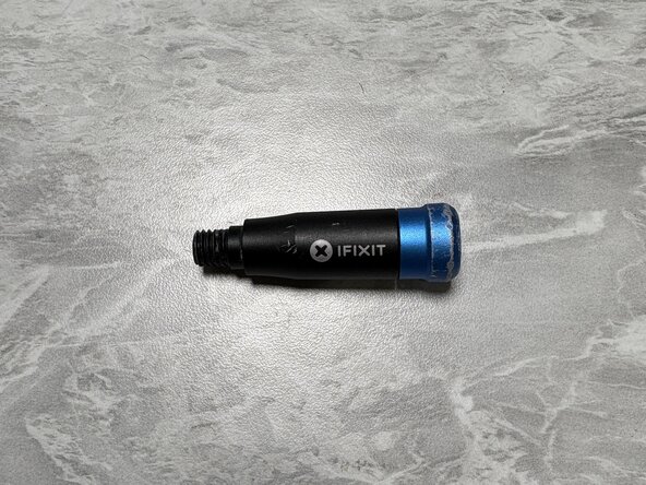

  1. iFixit Precision Bit Driver Reassembly, How to reinstall the bearing cap: 手順 1、 3の画像 1 iFixit Precision Bit Driver Reassembly, How to reinstall the bearing cap: 手順 1、 3の画像 2 iFixit Precision Bit Driver Reassembly, How to reinstall the bearing cap: 手順 1、 3の画像 3
    • Unscrew the center of the barrel
    • Note: Assembly utilizes threat locker. You may need tools to unscrew. Use a small piece of duct tape on the smooth part to protect the aluminum.
    • Use pliers on the duct tape, and an adjustable wrench on the flat of the knurled part near the bottom of the screw driver to create leverage to unscrew the barrel.

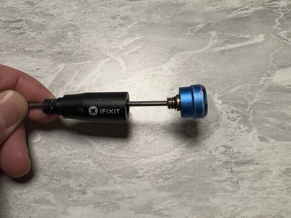

  2. iFixit Precision Bit Driver Reassembly: 手順 2、 3の画像 1 iFixit Precision Bit Driver Reassembly: 手順 2、 3の画像 2 iFixit Precision Bit Driver Reassembly: 手順 2、 3の画像 3
    • Next use a 2.5mm hex key with a long shaft such that it fits all the way through the top half of the screw driver.
    • Insert the bearing/top assembly onto the hex key, and begin tightening the bearing assembly into the screwdriver.
    • Note: threadlocker should not be necessary here as there is an O ring that is responsible for maintaining the thread loading
