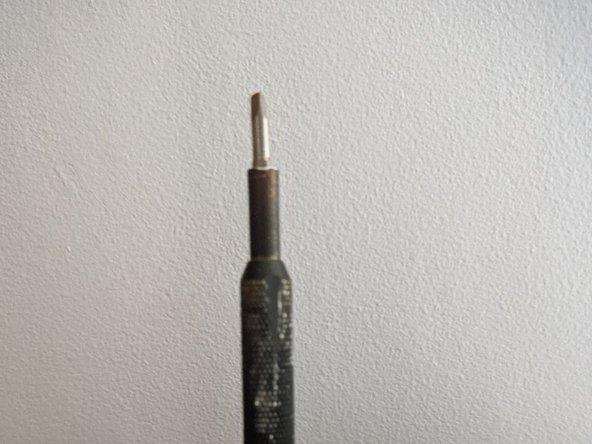

    1. iFixit Precision Bit Driver Magnet Replacement, Removing the cap: 手順 1、 2の画像 1 iFixit Precision Bit Driver Magnet Replacement, Removing the cap: 手順 1、 2の画像 2
      • Follow the Cap Replacement guide in reverse.
      • I found doing a few loops around the handle first helped tighten the floss around the cap
