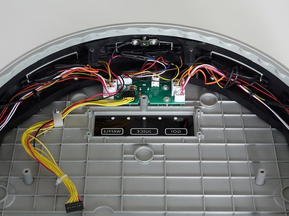

  6. bObi Pet Screen  Replacement, Detach the Cover: 手順 6、 3の画像 1 bObi Pet Screen  Replacement, Detach the Cover: 手順 6、 3の画像 2 bObi Pet Screen  Replacement, Detach the Cover: 手順 6、 3の画像 3
    • Lift the cover to reveal the main board underneath.
    • Remove the two circuit plugs connecting the lid to the mainboard.
    • bObi Pet's cover is entirely separated, and you may now access any of her internal parts for replacement.

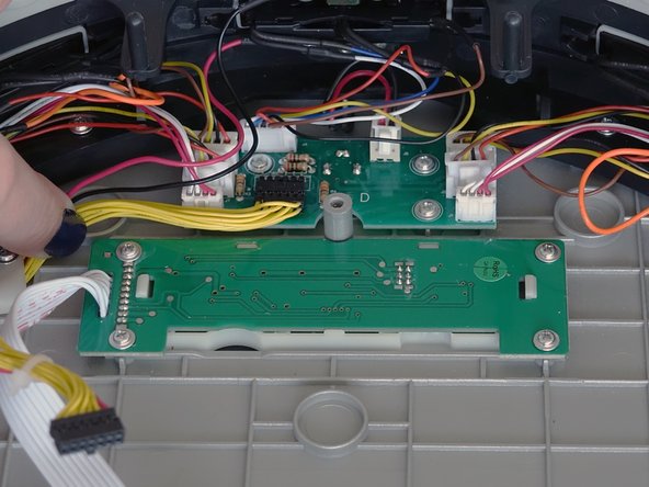

  7. bObi Pet Screen  Replacement, Remove the Screen: 手順 7、 3の画像 1 bObi Pet Screen  Replacement, Remove the Screen: 手順 7、 3の画像 2 bObi Pet Screen  Replacement, Remove the Screen: 手順 7、 3の画像 3
    • Remove the four screws holding bObi Pet's screen.
    • Then, lift it straight up and out to make space for the replacement.
    FixBotに聞いてみる
    コメントを追加
  8. bObi Pet Screen  Replacement, Place the New Screen: 手順 8、 3の画像 1 bObi Pet Screen  Replacement, Place the New Screen: 手順 8、 3の画像 2 bObi Pet Screen  Replacement, Place the New Screen: 手順 8、 3の画像 3
    • Lay the new screen in the open space on bObi Pet's lid.
    • Align the screw holes on the screen with the screw posts in bObi Pet and push down until it lies flat.
    • Install all four screws, and you'll be ready to close bObi Pet. See the following instructions: Assemble bObi Pet Post-Repair
