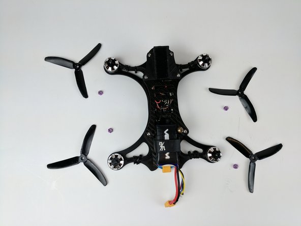

VooDooQuad 250 Propeller Replacement

    2. VooDooQuad  250 Propeller Replacement: 手順 2、 1の画像 1
      • With your set of pliers loosen and remove the four bolts holding the propellers to the motor.

    3. VooDooQuad  250 Propeller Replacement: 手順 3、 2の画像 1 VooDooQuad  250 Propeller Replacement: 手順 3、 2の画像 2
      • Gently remove the propellers perpendicular to the device.
      • When placing the new set of propellers on the drone, make sure that the wings angled upward are facing towards the center, or the battery.

終わりに
Be careful removing the bolts multiple times because it may create slippage and then this will not allow the bolt nor the propeller to stay on. To reassemble your device, follow these instructions in reverse order
