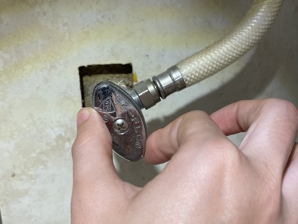

    2. Toilet Pull Chain Spring Clasp Replacement, Shutting off the Water Supply to a Toilet: 手順 2、 2の画像 1 Toilet Pull Chain Spring Clasp Replacement, Shutting off the Water Supply to a Toilet: 手順 2、 2の画像 2
      • Shut off the stop valve underneath the toilet by turning it clockwise until it becomes hand tight.
      • The appearance of this valve may differ from toilet to toilet, but most operate the same. Some valves require multiple turns to stop the water while others only require a quarter turn.

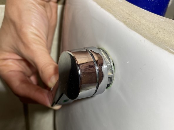

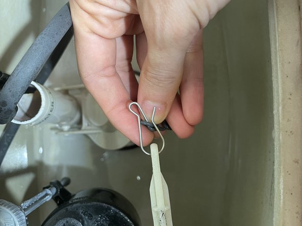

    4. Toilet Pull Chain Spring Clasp Replacement, Disassembling Toilet Pull Chain Spring Clasp from Tank Lever: 手順 4、 3の画像 1 Toilet Pull Chain Spring Clasp Replacement, Disassembling Toilet Pull Chain Spring Clasp from Tank Lever: 手順 4、 3の画像 2 Toilet Pull Chain Spring Clasp Replacement, Disassembling Toilet Pull Chain Spring Clasp from Tank Lever: 手順 4、 3の画像 3
      • Squeeze open the spring clasp that connects the pull chain to the tank lever.
      • Disconnect the spring clasp from the tank lever.
      • Use both hands to disconnect the spring clasp from the tank lever.

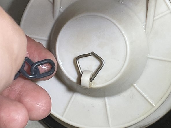

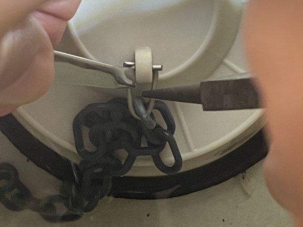

    5. Toilet Pull Chain Spring Clasp Replacement, Disassembling Toilet Pull Chain Spring Clasp Bottom Part: 手順 5、 3の画像 1 Toilet Pull Chain Spring Clasp Replacement, Disassembling Toilet Pull Chain Spring Clasp Bottom Part: 手順 5、 3の画像 2 Toilet Pull Chain Spring Clasp Replacement, Disassembling Toilet Pull Chain Spring Clasp Bottom Part: 手順 5、 3の画像 3
      この手順で使用する道具:
      • Use tweezers to grab the folded aluminum that is holding the chain.
      • Use pincers to grab the other side of the aluminum and pull on opposite directions to unfold the aluminum and release the chain.
      • Use the second picture as a reference to place the tweezers and pincers. Then pull-on opposite sides to open. View the last picture for results.
      • To reassemble your device, instead of pulling to opposite sides, fold the aluminum to its original form with the new chain inside.
