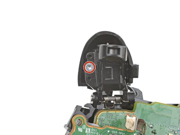

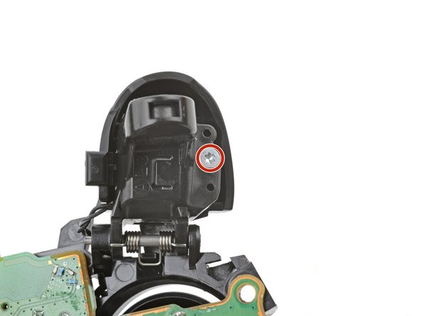

  18. Scuf Instinct Pro Triggers Replacement, Unfasten the triggers: 手順 18、 3の画像 1 Scuf Instinct Pro Triggers Replacement, Unfasten the triggers: 手順 18、 3の画像 2 Scuf Instinct Pro Triggers Replacement, Unfasten the triggers: 手順 18、 3の画像 3
    • Use a T6 Torx screwdriver to remove the 7 mm‑long screw securing each trigger (two total).

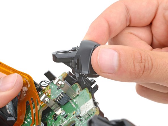

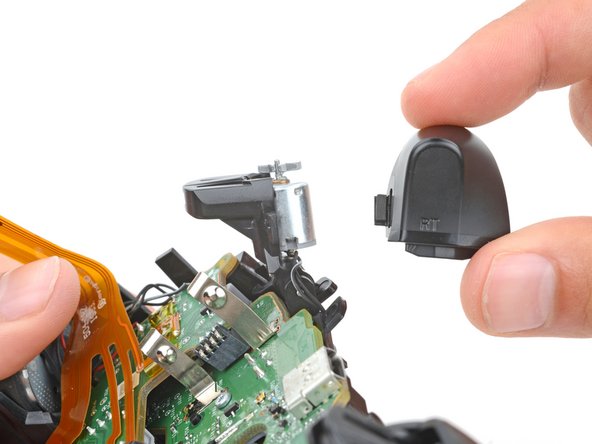

  19. Scuf Instinct Pro Triggers Replacement, Remove the triggers: 手順 19、 3の画像 1 Scuf Instinct Pro Triggers Replacement, Remove the triggers: 手順 19、 3の画像 2 Scuf Instinct Pro Triggers Replacement, Remove the triggers: 手順 19、 3の画像 3
    • A clip secures the inside edge of the trigger.
    • Rotate the trigger toward the center of the controller to unclip it.
    • Remove the trigger.

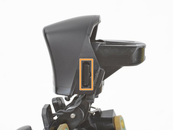

  20. Scuf Instinct Pro Triggers Replacement: 手順 20、 3の画像 1 Scuf Instinct Pro Triggers Replacement: 手順 20、 3の画像 2 Scuf Instinct Pro Triggers Replacement: 手順 20、 3の画像 3
    • Use the same process to remove the other trigger.
    • During reassembly:
    • Make sure the trigger rumble motors are correctly oriented (flat-side up) before installing a trigger.
    • To install a trigger, hook the inside edge onto its post and push the trigger until it snaps into place.
