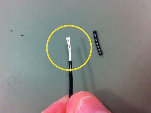

    4. Prep Black Wire: 手順 4、 2の画像 1 Prep Black Wire: 手順 4、 2の画像 2
      • Measure 20mm from either end of the wire.
      • With the flash cutters remove the instulation that is covering the wire.
      • Be careful not to cut to deep because you will damage the wire strands inside.
