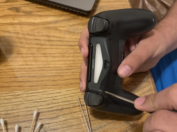

  1. Playstation Controller Fast Fix, Power Off and Disconnect: 手順 1、 1の画像 1
    • Turn off the controller and disconnect it.
    FixBotに聞いてみる
    コメントを追加
  2. Playstation Controller Fast Fix, Gather Tools: 手順 2、 1の画像 1
    • Prepare tools including a precision screwdriver set, plastic pry tool, tweezers, isopropyl alcohol, and cotton swabs.
    FixBotに聞いてみる
    コメントを追加
  3. Playstation Controller Fast Fix, Remove Outer Screws: 手順 3、 1の画像 1
    • Locate and remove all screws from the controller casing using a screwdriver. top and bottom.
    FixBotに聞いてみる
    コメントを追加
  4. Playstation Controller Fast Fix, Open the Controller Housing: 手順 4、 1の画像 1
    • Carefully pry open the controller using a plastic tool to avoid damaging components.
    FixBotに聞いてみる
    コメントを追加
  5. Playstation Controller Fast Fix, Disconnect Internal Components: 手順 5、 1の画像 1
    • Gently detach the battery and ribbon cables to access the motherboard, and then unscrew the motherboard retainer(black cover)
    FixBotに聞いてみる
    コメントを追加
  6. Playstation Controller Fast Fix, Locate the Analog Stick Module: 手順 6、 1の画像 1
    • Identify the joystick assembly attached to the circuit board. Note: look hard for this one. It's a bit small
    FixBotに聞いてみる
    コメントを追加
  7. Playstation Controller Fast Fix, Clean the Potentiometers: 手順 7、 1の画像 1
    • Apply isopropyl alcohol to the base of the analog stick and rotate it to remove dirt and other stuff. Note: be careful on how hard you clean with the swabs, and don't apply too much rubbing alcohol.
    FixBotに聞いてみる
    コメントを追加
  8. Playstation Controller Fast Fix, Reassemble and Test: 手順 8、 1の画像 1
    • Reconnect all components, close the controller, and test it to ensure the stick drift is resolved. Note: since the battery was removed during the procedure, charging the controller is a must after putting it back together.
    FixBotに聞いてみる
    コメントを追加
  9. Playstation Controller Fast Fix, Reassemble and Test: 手順 9、 1の画像 1
