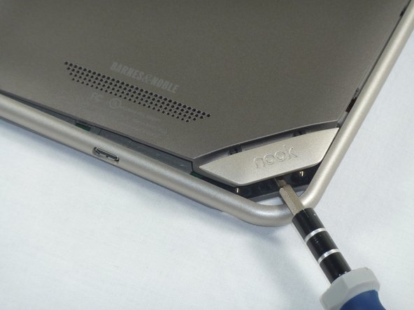

    3. Nook Tablet Display Replacement: 手順 3、 2の画像 1 Nook Tablet Display Replacement: 手順 3、 2の画像 2
      • Insert the flat end of a spudger between the front panel and the rear assembly.
      • Though these photos show a screwdriver, use a spudger or plastic opening tool in order to prevent damage to the device.
      • Use a spudger to lift the the back panel from the rest of the Nook.

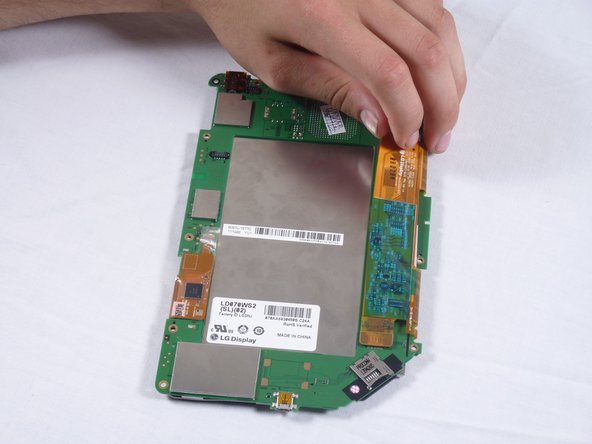

    1. Nook Tablet Display Replacement, Display: 手順 11、 2の画像 1 Nook Tablet Display Replacement, Display: 手順 11、 2の画像 2
      • Orient the mother board as shown, so that the screen is facing downwards.
      • Grab the corner of the orange strip on the right side of the mother board as shown.
      • The orange strip is adhered to the mother board, gently lift the strip so that the adhesion is broken.
      • The strip will still be attached by the circuit connection to the mother board, proceed to the next step.

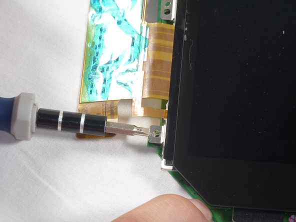

    2. Nook Tablet Display Replacement: 手順 12、 3の画像 1 Nook Tablet Display Replacement: 手順 12、 3の画像 2 Nook Tablet Display Replacement: 手順 12、 3の画像 3
      • The orange strip will still be attached at this point
      • Insert the end of a flat head screw driver between the connection of the strip and mother board and pry upward.
      • Grab the strip and gently pull upward to finish the disconnection.
