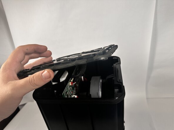

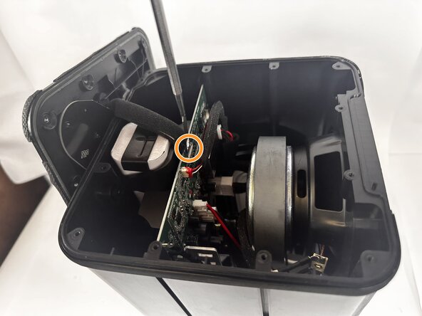

    2. Logitech UE Hyperboom Power Button Board Replacement: 手順 3、 3の画像 1 Logitech UE Hyperboom Power Button Board Replacement: 手順 3、 3の画像 2 Logitech UE Hyperboom Power Button Board Replacement: 手順 3、 3の画像 3
      • Use a Phillips #0 screwdriver to remove the ten 11.7mm screws on the top panel.
      • Remove the top panel to access the internal components.
      • Use a metal spudger to completely disconnect the top panel.

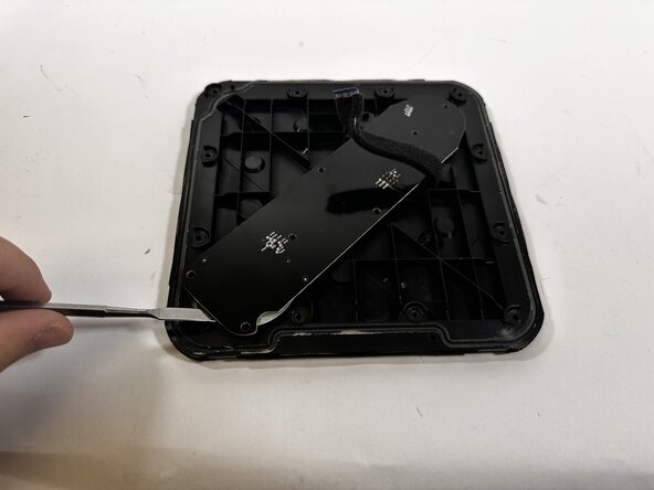

    1. Logitech UE Hyperboom Power Button Board Replacement, Power Button Board: 手順 4、 3の画像 1 Logitech UE Hyperboom Power Button Board Replacement, Power Button Board: 手順 4、 3の画像 2 Logitech UE Hyperboom Power Button Board Replacement, Power Button Board: 手順 4、 3の画像 3
      • Use the Phillips #0 screwdriver to unscrew the seven 6.5mm screws on the circuit board.
      • Use a metal spudger to disconnect the power button board from the panel.
