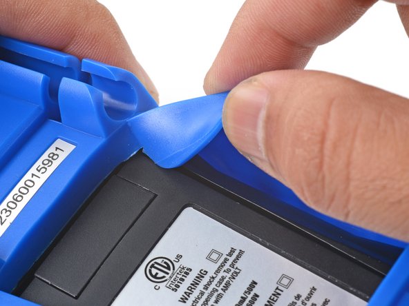

  2. How to Reinstall the iFixit Digital Multimeter Outer Cover: 手順 2、 3の画像 1 How to Reinstall the iFixit Digital Multimeter Outer Cover: 手順 2、 3の画像 2 How to Reinstall the iFixit Digital Multimeter Outer Cover: 手順 2、 3の画像 3
    • Flip the multimeter over.
    • The cover has a lip that needs to seat into the groove around the multimeter's kickstand.
    • Align and press the cover lip into the groove above the kickstand.
  3. How to Reinstall the iFixit Digital Multimeter Outer Cover: 手順 3、 3の画像 1 How to Reinstall the iFixit Digital Multimeter Outer Cover: 手順 3、 3の画像 2 How to Reinstall the iFixit Digital Multimeter Outer Cover: 手順 3、 3の画像 3
    • Lift and tuck the cover lip into the groove near the top right corner of the kickstand.
    • Repeat the procedure for the top left corner of the kickstand.
