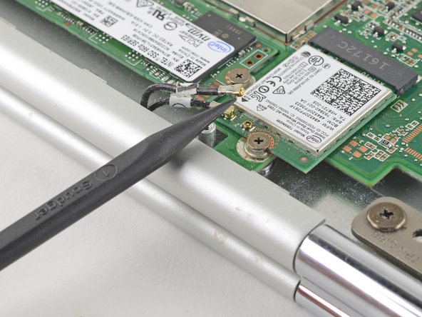

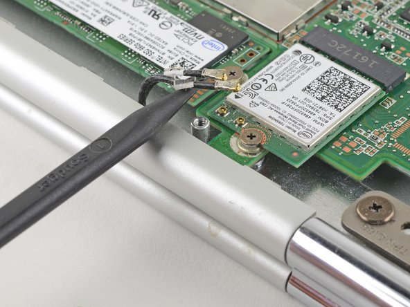

  6. HP Spectre x360 15" (15t-ap000) Wi-Fi Card Replacement: 手順 6、 3の画像 1 HP Spectre x360 15" (15t-ap000) Wi-Fi Card Replacement: 手順 6、 3の画像 2 HP Spectre x360 15" (15t-ap000) Wi-Fi Card Replacement: 手順 6、 3の画像 3
    • Use the point of a spudger to carefully pry up and disconnect the two antenna cables from the Wi-Fi card.
