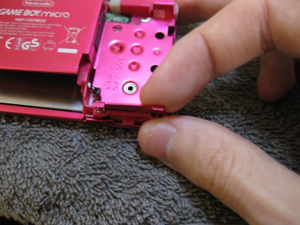

    2. Game Boy Micro Outer shell Replacement, Remove the backplate: 手順 4、 3の画像 1 Game Boy Micro Outer shell Replacement, Remove the backplate: 手順 4、 3の画像 2 Game Boy Micro Outer shell Replacement, Remove the backplate: 手順 4、 3の画像 3
      • Unscrew these two tri-point screws holding the backplate in place.
      • The other screws keep the PCB and the plastic frame together, it's not necessary to unscrew these for outer shell replacement.
      • Start to lift out the backplate near the top-right corner, and then you can gently wiggle it up and off.
      • When putting the new backplate back on, make sure that the bottom-right corner is flush with the plastic frame. If it isn't, lift out the entire backplate, and try lowering it again, but try gently pinching the plastic frame and the backplate together, like shown on the 3rd image. Do not try forcing it into place, it will not work!

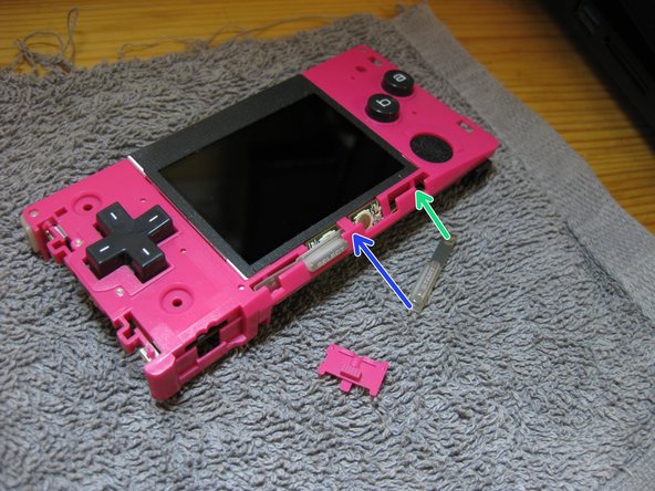

    4. Game Boy Micro Outer shell Replacement, Remove the frontplate: 手順 6、 3の画像 1 Game Boy Micro Outer shell Replacement, Remove the frontplate: 手順 6、 3の画像 2 Game Boy Micro Outer shell Replacement, Remove the frontplate: 手順 6、 3の画像 3
      • Grab the frontplate like shown
      • Lift the frontplate up and away
      • Start to lift the top part upwards
      • While lifting, try to unhook the bottom catches to let you lift the frontplate away
      • It's okay if the power switch and the Start/Select buttons fall out, they always do. Just remember to put them back before re-assembling!
      • Insert the short part of the Start/Select buttons in the middle first
      • Then lay the long part into its groove. It should just rest in there, do not press on it at all!
