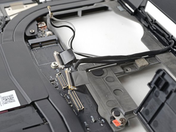

  33. Framework Laptop 16" Mainboard Replacement, Disconnect the speaker: 手順 33、 2の画像 1 Framework Laptop 16" Mainboard Replacement, Disconnect the speaker: 手順 33、 2の画像 2
    • Lift the speaker cable connector by its black pull tab and disconnect it.
  34. Framework Laptop 16" Mainboard Replacement, Disconnect the display: 手順 34、 3の画像 1 Framework Laptop 16" Mainboard Replacement, Disconnect the display: 手順 34、 3の画像 2 Framework Laptop 16" Mainboard Replacement, Disconnect the display: 手順 34、 3の画像 3
    • Lift the two display connectors by their black pull tabs to disconnect them.
  35. Framework Laptop 16" Mainboard Replacement, Reroute the cables: 手順 35、 3の画像 1 Framework Laptop 16" Mainboard Replacement, Reroute the cables: 手順 35、 3の画像 2 Framework Laptop 16" Mainboard Replacement, Reroute the cables: 手順 35、 3の画像 3
    • Lift the display and Wi-Fi card cables out of their slot in the frame enough to give room for the mainboard to lift straight up.
    • During reassembly, make sure the cables are routed properly in their slot so the midframe can sit flat on the frame.

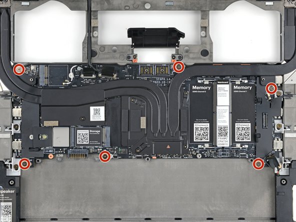

  36. Framework Laptop 16" Mainboard Replacement, Remove the mainboard screws: 手順 36、 3の画像 1 Framework Laptop 16" Mainboard Replacement, Remove the mainboard screws: 手順 36、 3の画像 2 Framework Laptop 16" Mainboard Replacement, Remove the mainboard screws: 手順 36、 3の画像 3
    • Lift up the interposer door to reveal the screw underneath.
    • The mainboard screws are ordered from 1–6. You don't have to follow the order, but you can use it to help keep track of the screws you've removed.
    • Use a T5 Torx screwdriver to remove the six 2 mm‑long screws securing the mainboard.
  37. Framework Laptop 16" Mainboard Replacement, Remove the mainboard: 手順 37、 3の画像 1 Framework Laptop 16" Mainboard Replacement, Remove the mainboard: 手順 37、 3の画像 2 Framework Laptop 16" Mainboard Replacement, Remove the mainboard: 手順 37、 3の画像 3
    • Grab the mainboard by the curving pipes of its heatsink.
    • Lift the mainboard off its alignment pegs and remove it.
    • During reassembly, make sure all of the cables are above the mainboard before securing it back to the frame.
