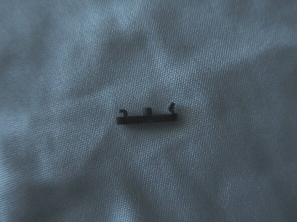

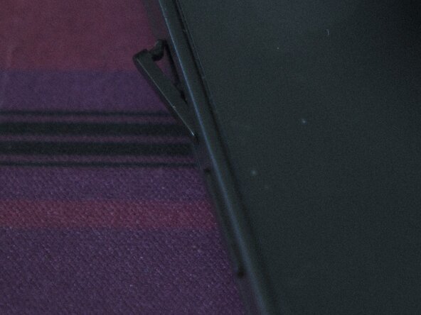

    1. Fairphone 6 Volume Button Replacement/Reseating, The Initial Situation/Problem: 手順 1、 3の画像 1 Fairphone 6 Volume Button Replacement/Reseating, The Initial Situation/Problem: 手順 1、 3の画像 2 Fairphone 6 Volume Button Replacement/Reseating, The Initial Situation/Problem: 手順 1、 3の画像 3
      • This is the initial scenario - the button got loose. Carefully pulling on it revealed the kinked plastic latch which partly detached from the button.

    2. Fairphone 6 Volume Button Replacement/Reseating, Get a working button: 手順 2、 3の画像 1 Fairphone 6 Volume Button Replacement/Reseating, Get a working button: 手順 2、 3の画像 2 Fairphone 6 Volume Button Replacement/Reseating, Get a working button: 手順 2、 3の画像 3
      • Either fix the old button by very carefully applying superglue (the way I fixed mine) or ask the Fairphone Support to provide you one.
      • If applying superglue, start on the tweezer as a transfer/portioning. Use some kind of paper to soak up any remains as the tolerances on the volume button insert are very small.
      • The holders of the button are not identical on both ends, one is slightly reaching outside of the buttons form while the other stops at the button's length.
      • Apply the superglue on the kinked part and set it in the correct 90° angle.
      • The images show only the defect button.
      • Removing the button leads to exposed PCB and could damage your phone if not protected from the elements.

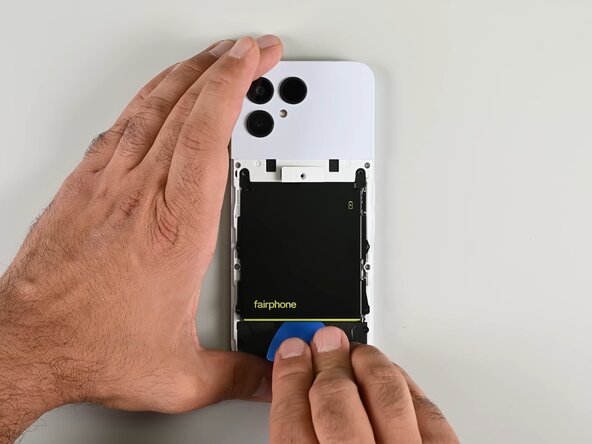

    4. Fairphone 6 Volume Button Replacement/Reseating, Remove the battery: 手順 4、 3の画像 1 Fairphone 6 Volume Button Replacement/Reseating, Remove the battery: 手順 4、 3の画像 2 Fairphone 6 Volume Button Replacement/Reseating, Remove the battery: 手順 4、 3の画像 3
      • Remove the five black screws holding the battery into place.
      • Carefully lift the protective cover on the top and disconnect the battery connector.
      • Lift the battery away, set it aside for re-assembly later.

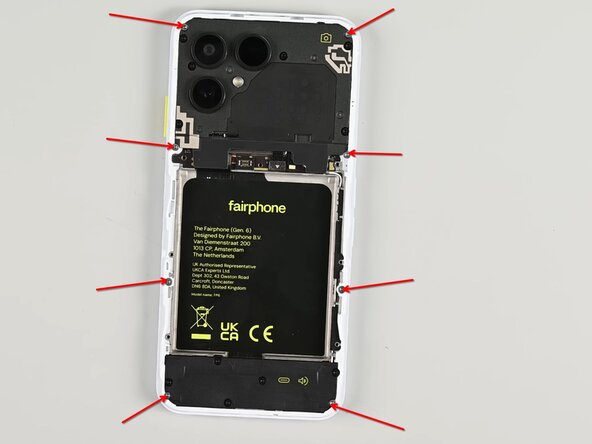

    6. Fairphone 6 Volume Button Replacement/Reseating, Unscrew/Remove the FP6 Screen: 手順 6、 3の画像 1 Fairphone 6 Volume Button Replacement/Reseating, Unscrew/Remove the FP6 Screen: 手順 6、 3の画像 2 Fairphone 6 Volume Button Replacement/Reseating, Unscrew/Remove the FP6 Screen: 手順 6、 3の画像 3
      • As we can not access the mechanism on this side, we are required to remove the screen as a next step.
      • To remove the screen first unscrew all 8 SILVER screws noted in the picture.
      • If your FP6 was never opened and cleaned like this it may be held in the frame by dust etc. building up between. I had the most success on the lower part of the screen when trying to get it out of the frame.
      • Do not let the screen fall out - there is a sensitive ribbon cable on the back which could tear.
      • Carefully wiggle the screen free.
      • Look behind the screen. The ribbon cable is held fast by a latch and a corresponding screw. Carefully unscrew the latch and remove the cable from the socket.
      • Set the screen and the latch with the corresponding screw aside.

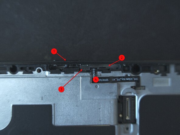

    8. Fairphone 6 Volume Button Replacement/Reseating, Fix the button: 手順 8、 2の画像 1 Fairphone 6 Volume Button Replacement/Reseating, Fix the button: 手順 8、 2の画像 2
      • (1) shows the still working button and how the mechanism is supposed to work.
      • (2) is the slot where our new/fixed button needs to be seated. It is currently blocked by the silver bracket in the middle, marked as (3).
      • (3) is the silver bracket holding both buttons seated.
      • (4) is the ribbon cable enabling the functionality of the buttons.
      • Careful while disassembling the mechanism - the ribbon cable is very close and could be damaged while seating/unseating the bracket or the button(s).
      • Lift the bracket (3) and seat the new button into the socket (4), the button can be placed from inside the frame after the bracket is removed.
      • Ensure that both buttons (1) and (2) are seated so that the LONGER part of the Bracket is holding the latches of the buttons.
      • The correct seating for the bracket from the orientation of the first picture top to bottom is: Phone Frame - Bracket - Latch(es)
