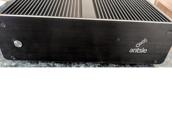

  1. Disassembling Antsle One D Server, Remove Front Plate: 手順 1、 3の画像 1 Disassembling Antsle One D Server, Remove Front Plate: 手順 1、 3の画像 2 Disassembling Antsle One D Server, Remove Front Plate: 手順 1、 3の画像 3
    • Remove the screws from the front panel.
    • There are also two screws in the front bottom of the plate that need to be removed.
    • When pulling the plate away from the body, be careful as a spring is keeping the silver button in place. The spring also easily slips off the button. Keep an eye out so you don't lose either of these items.

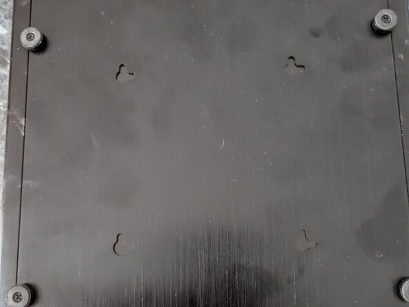

  2. Disassembling Antsle One D Server, Remove bottom plate: 手順 2、 2の画像 1 Disassembling Antsle One D Server, Remove bottom plate: 手順 2、 2の画像 2
    • To remove the bottom plate, remove the four-foot screws and the two screws from the rear plate, and the bottom will slide out.

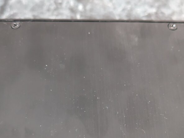

  3. Disassembling Antsle One D Server, Remove Back Plate: 手順 3、 1の画像 1
    • Remove the four screws from the rear plate
    • Unscrew the DC input connector
    • After, completing the previous step, and these six screws are removed, you can safely detach the rear plate.
    FixBotに聞いてみる
    コメントを追加

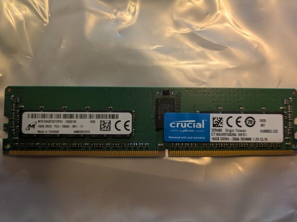

  7. Disassembling Antsle One D Server, CPU & RAM: 手順 8、 2の画像 1 Disassembling Antsle One D Server, CPU & RAM: 手順 8、 2の画像 2
    • CPU - Intel C3558 SR388 2.20GHZ
    • RAM - DDR4 2666 RDIMM 1.2v CL19
