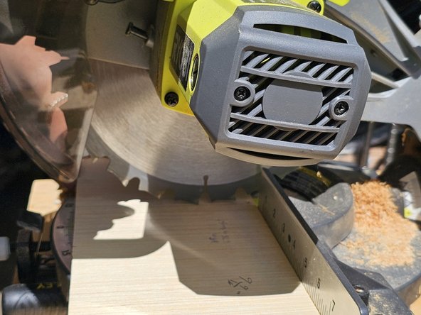

    3. Book Cover Replacement: 手順 3、 2の画像 1 Book Cover Replacement: 手順 3、 2の画像 2
      • Use safety eye protection and keep your hands away from the blade. Ask for help from a trained professional to use power tools.
      • Use a power saw to carefully cut your binder's board. Lower the blade to the board before activating the saw.

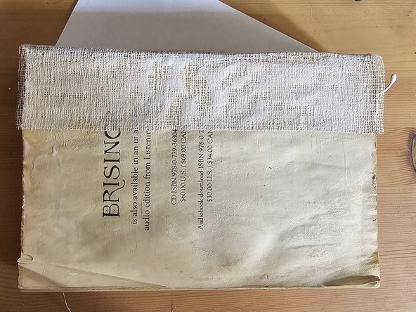

    4. Book Cover Replacement: 手順 4、 3の画像 1 Book Cover Replacement: 手順 4、 3の画像 2 Book Cover Replacement: 手順 4、 3の画像 3
      • Using your binder's board spine and book repair cloth, measure about 4cm on the left and right sides of the spine (length wise). Keep the top and bottom flush.
      • Cut the book repair cloth and place evenly on the spine of your book. The excess will go over the front and back of the book.
      • Use Mod Podge Crafting Glue and a large flat brush to coat the repair cloth onto the spine. It should look like it is "melting" into the book. Let dry for around 30 minutes or no longer tacky.

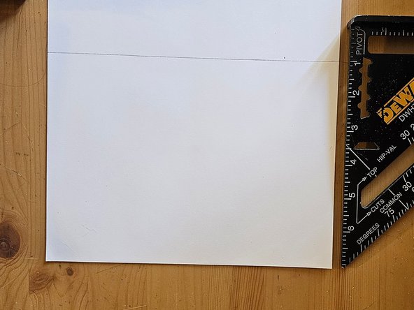

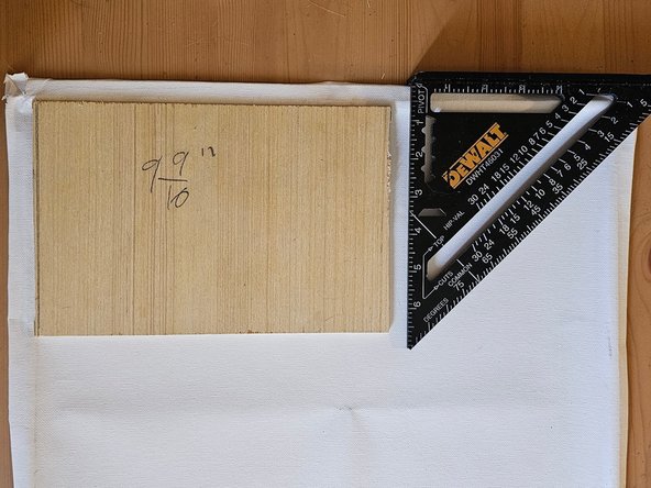

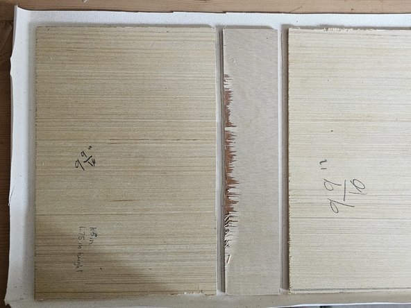

    5. Book Cover Replacement: 手順 5、 3の画像 1 Book Cover Replacement: 手順 5、 3の画像 2 Book Cover Replacement: 手順 5、 3の画像 3
      • Lay out your pieces as shown in the picture. There is about a 1cm gap between the spine and covers.
      • Lay out your pieces onto canvas. Measure, mark, and leave a 1cm gap along the perimeter of each piece. We are going to need the excess.
      • Measure the exact length and width of the covers onto flyleaf paper and cut neatly.
      FixBotに聞いてみる

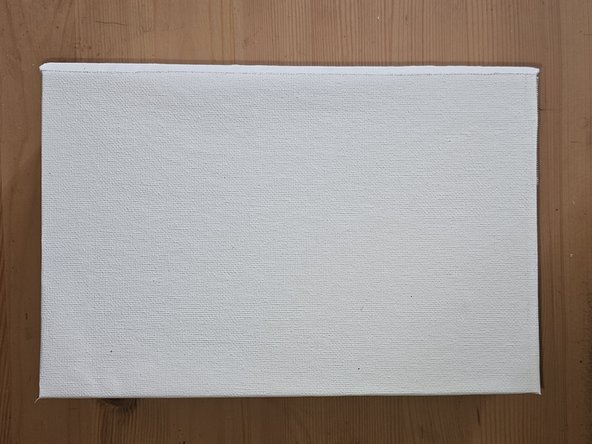

    6. Book Cover Replacement: 手順 6、 3の画像 1 Book Cover Replacement: 手順 6、 3の画像 2 Book Cover Replacement: 手順 6、 3の画像 3
      • Cut the canvas along the perimeter previously marked. Do not cut between the pieces.
      • Cut at the corners of the spine. It should be completely vertical. This will allow a more flush and complete end result.
      • Carefully fold and glue over the edges on the side currently facing you. Let dry for around 30 minutes.
