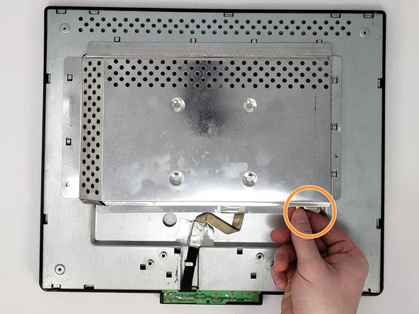

  3. Acer AL1716 Capacitor Replacement: 手順 3、 3の画像 1 Acer AL1716 Capacitor Replacement: 手順 3、 3の画像 2 Acer AL1716 Capacitor Replacement: 手順 3、 3の画像 3
    • Remove the two 0.7 mm Phillips #0 screws on the sides of the centerpiece motherboard cover.
    • Remove by hand the two hexagonal screws securing the digital visual interface (DVI) input.
    • The DVI is typically a blue/black connector with two built-in screw connections on either side. It is secured by hand tightening the two side screws.
    • Push the centerpiece motherboard cover toward the body to remove.

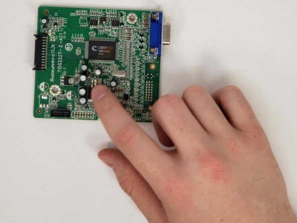

  6. Acer AL1716 Capacitor Replacement: 手順 6、 2の画像 1 Acer AL1716 Capacitor Replacement: 手順 6、 2の画像 2
    • Examine the top of each capacitor to check capacitor life.
    • A domed top surface indicates a blown capacitor that needs to be replaced.
    • Replace necessary capacitors via soldering the old capacitor out and soldering a new capacitor in.
    • Refer to this soldering guide for はんだ付けとはんだ除去の作業ガイド.
