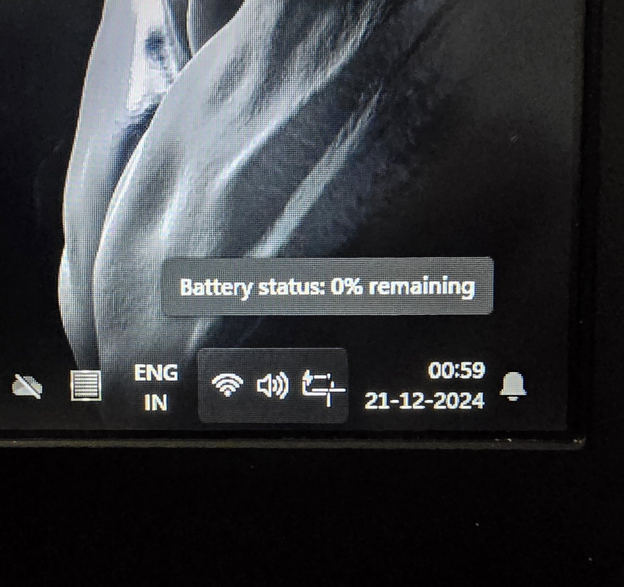

Battery doesn't charge
It does not power on unless the charger is connected; therefore, it only functions when constantly plugged in, essentially behaving like a desktop computer instead of a laptop.

I tried it, and the full charge capacity is 45122 mWh, while the design capacity is 57488 mWh. So I think there's another problem. And, as per the battery status, it shows: Battery status: 0% remaining. I am still stuck here. Thanks, btw.

The battery report is showing that there's 0% in the battery which either means it is totally discharged or the software can't read the information from it that is supplied by the hardware.
The only way to determine what the problem is, is to open the laptop and then first check what voltage is measured on the battery by using a voltmeter and go from there.
If it is 0V then you need to find out whether any charging voltage from the power adapter is getting to it or not.
If none then there's a motherboard problem. If there is then the battery is faulty and will need to be replaced.
