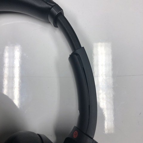

2. The extension sliders are both broken, and have been for a couple of years (I'm lazy so I just taped them). I'm now trying to find a way to permanently repair them but can't seem to find any reliable spare parts that are not ludicrously expensive (Sony's seem to be like 50€ PER SLIDER. Does anyone have any tips on how to find such replacement parts?
Example of cracked extender i found online:
画像
画像
This is exactly what happened on both sides of my headphones, it seems to be quite a common issue.
Thanks a lot for answers! I'm a student so don't really wanna drop 300€ on new ones if these ones can be repaired :).
EDIT: Issue has been solved so I figured I'd post what fixed it for me. The crackling was due to corrosion on the connector to the gesture control touch board. Probably caused some sort of short that then messed with the speakers. So get some Isopropyl alcohol and rub it off :)
I also fixed the sliders with the help of a friend that does 3D printing. There apparently are existing 3D models of the parts, so they can easily be printed and replaced. There are guides for this online that explains it better than I ever could.

Hi, thanks for such a quick answer! I took a look at the logic board and can see no corrosion, the corrosion only exists on the screws inside of the earcup (below the cushioning). I added some images of the sliders from someone who experienced the same issue online. This seems to be quite a common issue with these headphones!
さんによる
@luddoro looks like the angle is to steep for the slider to move and hence it breaks. I found some body parts for your model on ebay but that may not help you since we do not know where you are located (prices maybe different for you)and how much is to much....:-) You got some pretty good (and fairly pricey) headphones there so you know people are going to charge more for parts.
さんによる
@oldturkey03 Yep seems to be the case indeed. I did actually remember that I know a guy who does 3D printing on the side, and he said he should be able to make some parts really cheap. So we'll see if that works out :) !
