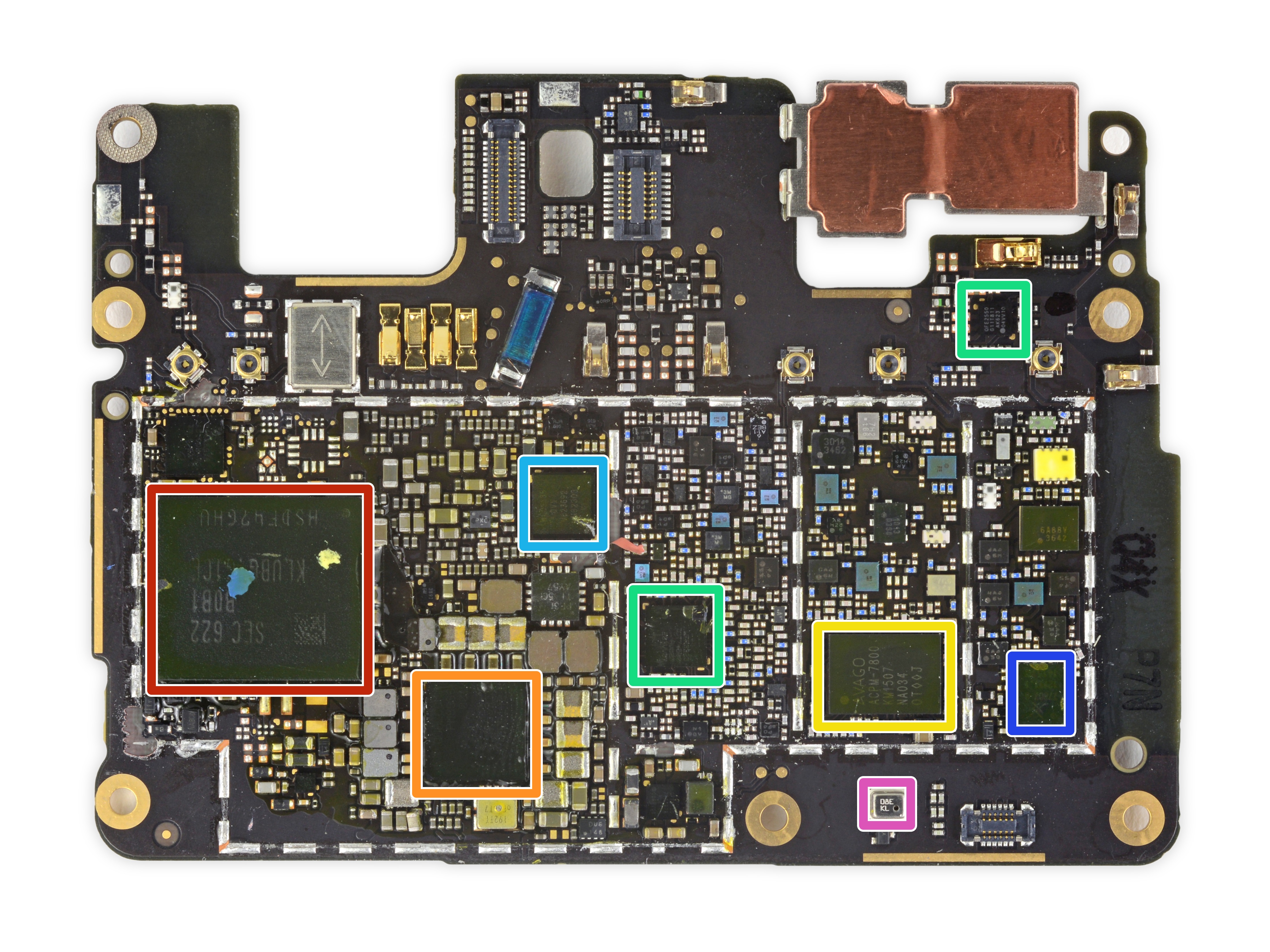

Hey guys i found a fix for the mic problem IF YOUR PROBLEM IS HARDWARE RELATED. So through some research I saw that the problem is that the Qualcomm WCD9335 audio codec chip located on the back of the motherboard has a tendency to have some of the solder joints disconnect and cause audio issues. I found a fix but its a little bit of work. So you basically need to reflow the solder on the audio chip to restore the connections. I accomplished this by removing the motherboard from the phone and heating the entire board for about 30 secs with a precision heat tool and then covering the board with foil except for a cut out where the audio chip is located. I heated the chip for another 20 secs and then waited for the board to cool down to room temperature before reassembly. So far it seems to have worked, its been about a week. I used the tear down of the google pixel XL as reference when I did this. NOTE: DO NOT OVERHEAT THE BOARD, USE MINIMAL HEAT AND GO SLOW!

Hi Brendan,
on behalf of my friend here (and mine of course). Could you highlight the location of the audio chip on the motherboard. We want to be double triple confirmed so that we won't mess anything else. If it doesn't trouble you that'd be awesome and greatly helpful.
Thanks!
さんによる 共有
https://photos.app.goo.gl/uDGCoFQS3ak3Gb...
This link has my phone's motherboard pics. You can highlight there.
さんによる 共有
https://d3nevzfk7ii3be.cloudfront.net/ig...
This is a pic from the ifixit tear down of the pixel XL, although it is not the non-XL the components are all located in the same relative locations. The chip in the lighter blue square near the center of the board is the audio chip.
さんによる 共有

Ifixit's teardown is for the pixel XL. It is likely different for that phone. Besides, replacement of the microphone wouldn't cut it. A microphone is an analog device, like headphones. That means, no digital signals are being sent between the mic and motherboard. So if toggling the speaker phone fixes the problem, it can't be fixed by replacing the mic.
