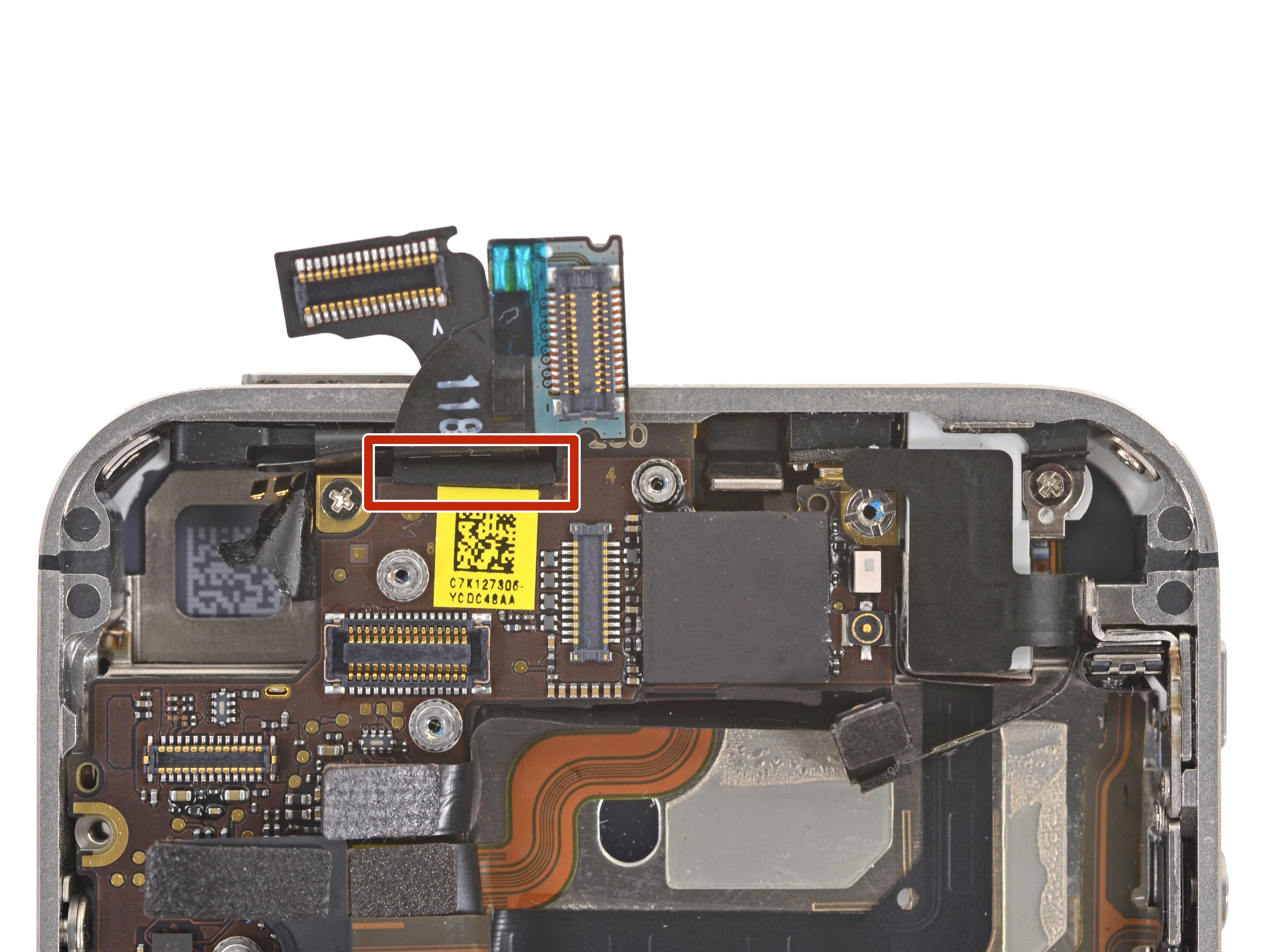

  15. iPhone 4 Verizon Home Button Replacement, Logic Board: 手順 15、 1の画像 1
    • Disconnect the five cables near the top of the logic board in the following order:
    • Headphone jack/volume button cable
    • Power button cable
    • Front facing camera cable
    • Digitizer cable
    • Display data cable
    • To disconnect the cables, use the edge of a plastic opening tool to gently lift their connectors up and out of the sockets on the logic board.
    • Be careful not to break any of the small and delicate surface mount components as you disconnect the cables.
    FixBotに聞いてみる

  37. iPhone 4 Verizon Home Button Replacement, Home Button: 手順 37、 2の画像 1 iPhone 4 Verizon Home Button Replacement, Home Button: 手順 37、 2の画像 2
    • Use a clean fingernail or the edge of a plastic opening tool to flip up the retaining flap on the home button ribbon cable.
    • Be sure you are prying up on the hinged flap, not the socket itself.
    FixBotに聞いてみる
    コメントを追加
  38. iPhone 4 Verizon Home Button Replacement: 手順 38、 1の画像 1
    この手順で使用する道具:
    • Use a pair of tweezers to pull the home button cable out of its socket.
    FixBotに聞いてみる
    コメントを追加
  39. iPhone 4 Verizon Home Button Replacement: 手順 39、 1の画像 1
    • Carefully de-route the home button cable through its slot in the outer case and remove it from the iPhone.
    FixBotに聞いてみる
    コメントを追加
