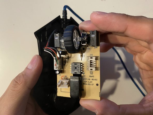

  4. Xtreme Gaming XG-700 Internal Switch Replacement: 手順 4、 2の画像 1 Xtreme Gaming XG-700 Internal Switch Replacement: 手順 4、 2の画像 2
    • Using a small plastic spudger, release the four clips from each corner of the board.
    • Gently remove the board out of the case.
    • Don't yank or pull the board off the case. There is one cable connecting the board to the case.

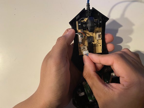

  5. Xtreme Gaming XG-700 Internal Switch Replacement: 手順 5、 1の画像 1
    • Carefully disconnect the ribbon cable from the board.
    • Set aside the case.

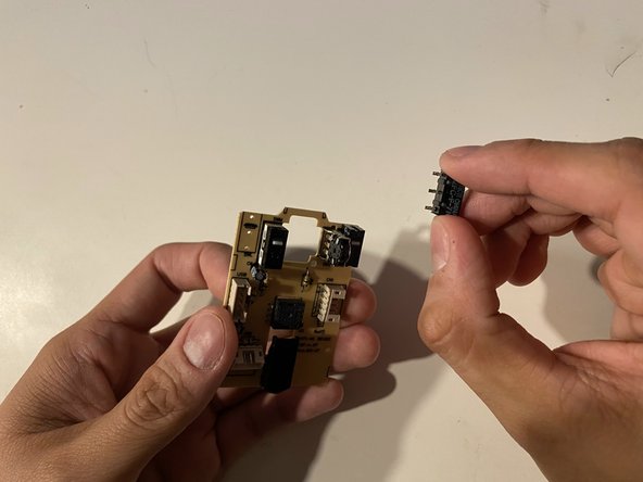

  6. Xtreme Gaming XG-700 Internal Switch Replacement: 手順 6、 2の画像 1 Xtreme Gaming XG-700 Internal Switch Replacement: 手順 6、 2の画像 2
    • Flip the motherboard over, and using a soldering iron, desolder the three switch prongs on each side of the switch.
    • Remove the broken switch.
