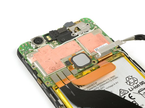

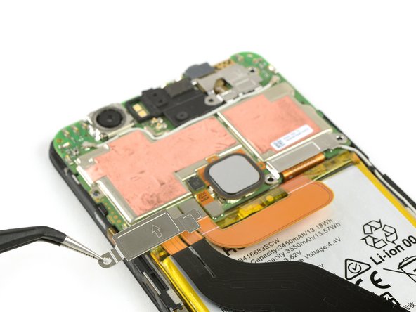

    • Remove the six Phillips #000 screws.
    • Use tweezers to remove the metal shields covering the battery/main flex cable and the display flex cable.

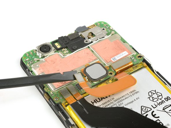

    • Unplug the antenna cable with tweezers.
    • Use a spudger to disconnect the display and battery flex cable.

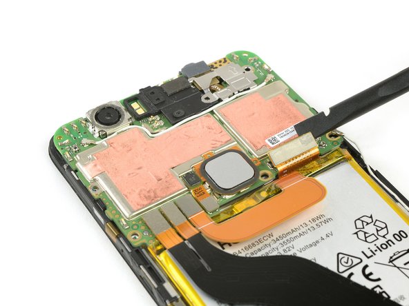

  9. Nexus 6P Rear Camera Replacement: 手順 9、 3の画像 1 Nexus 6P Rear Camera Replacement: 手順 9、 3の画像 2 Nexus 6P Rear Camera Replacement: 手順 9、 3の画像 3

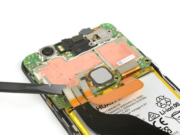

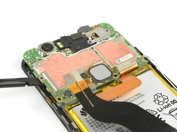

    • Use a spudger to disconnect the main flex cable.
    • Pry up the motherboard with a spudger until you can get a good grip.

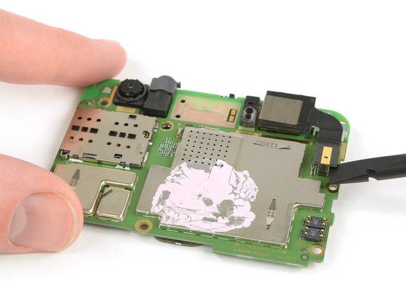

    • Flip the motherboard and disconnect the rear camera flex cable with a spudger.
    • Carefully remove the rear camera with tweezers.
