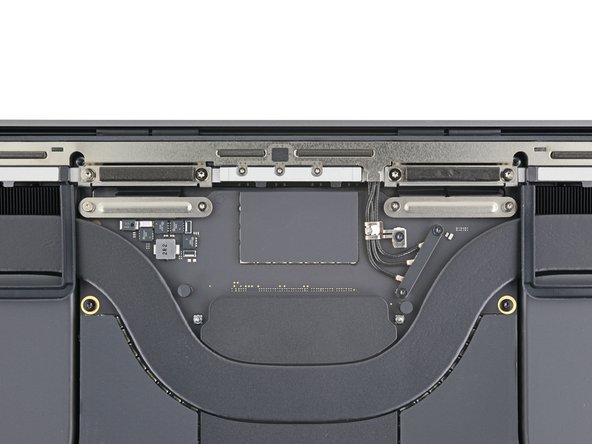

  21. MacBook Pro 16" Late 2023 Screen Replacement, Unfasten the antenna bar's connector bracket: 手順 21、 2の画像 1 MacBook Pro 16" Late 2023 Screen Replacement, Unfasten the antenna bar's connector bracket: 手順 21、 2の画像 2
    • Use a 3IP Torx Plus screwdriver to remove the three 2.1 mm screws securing the antenna board bracket and coaxial cable cover to the frame.
  22. MacBook Pro 16" Late 2023 Screen Replacement: 手順 22、 2の画像 1 MacBook Pro 16" Late 2023 Screen Replacement: 手順 22、 2の画像 2
    この手順で使用する道具:
    • Use tweezers, or your fingers, to remove the cover on top of the antenna bar's coaxial cables.
  23. MacBook Pro 16" Late 2023 Screen Replacement, Disconnect the antenna bar: 手順 23、 2の画像 1 MacBook Pro 16" Late 2023 Screen Replacement, Disconnect the antenna bar: 手順 23、 2の画像 2
    • Use the tip of a spudger to pry up and disconnect the antenna bar's coaxial cable.
    • Repeat for the two other cables.
    • During reassembly, these can be tricky to reconnect. One at a time, hold each connector in place over its socket and press down with the flat end of a spudger. The connector should snap into place.
  24. MacBook Pro 16" Late 2023 Screen Replacement, Unfasten the antenna bar: 手順 24、 2の画像 1 MacBook Pro 16" Late 2023 Screen Replacement, Unfasten the antenna bar: 手順 24、 2の画像 2
    • Use a 5IP Torx Plus screwdriver to remove the six screws securing the antenna bar to the frame:
    • Two 7.5 mm screws
    • Four 3 mm screws
    • Use a P2 Pentalobe driver to remove the nine 1.5 mm screws securing the antenna bar to the frame.
    • These screws strip very easily; use constant downward pressure and work slowly when you loosen these.
