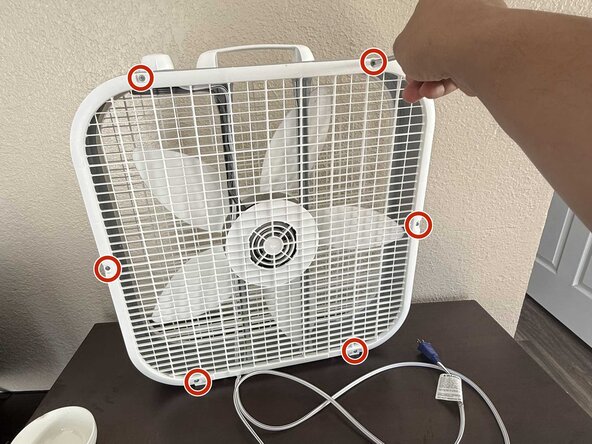

    • Remove the six 1.5 mm Phillips #1 screws on both sides of the fan.
    • Gently push both side covers upward while applying light pressure to remove the fan guard.

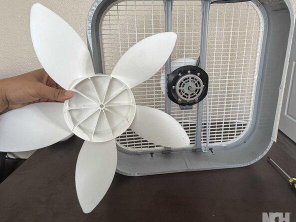

    • Lift the fan blade assembly directly up and off the rotor.

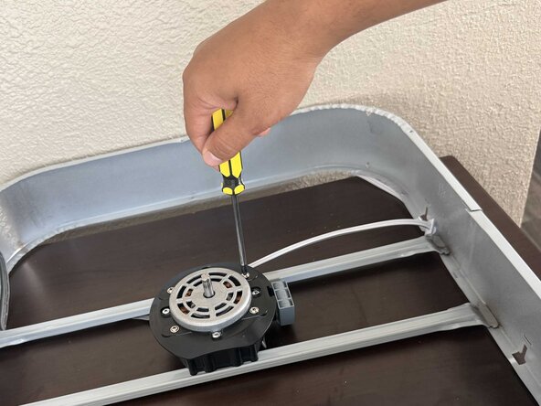

    • Remove the four 1.5 mm Phillips #1 screws securing the rotor cover.

    • Turn the fan over to access the back of the frame.
    • Remove the four 1.5 mm Phillips #1 screws securing the rotor to the frame.
    • Lift the cover off the rotor.

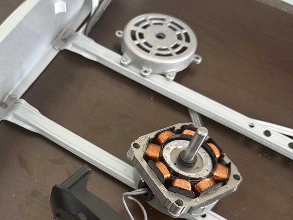

    • Remove the four 1.5 mm screws that secure the rotor cover.
    • Remove the rotor cover.

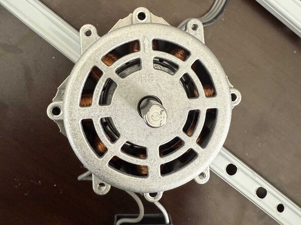

  6. Lasko B20200 Rotor Replacement: 手順 6、 3の画像 1 Lasko B20200 Rotor Replacement: 手順 6、 3の画像 2 Lasko B20200 Rotor Replacement: 手順 6、 3の画像 3

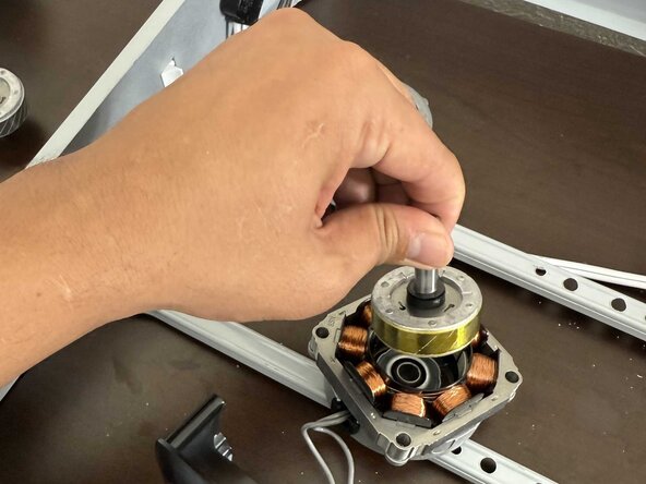

    • Carefully detach and remove the old rotor.
    • Place the new rotor inside.
    • Align it properly and secure it with the screws.
  7. Lasko B20200 Rotor Replacement: 手順 7、 2の画像 1 Lasko B20200 Rotor Replacement: 手順 7、 2の画像 2

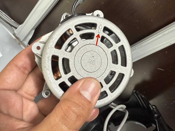

    • Ensure both arrows on the front and back of the rotor are aligned correctly for proper reassembly.
