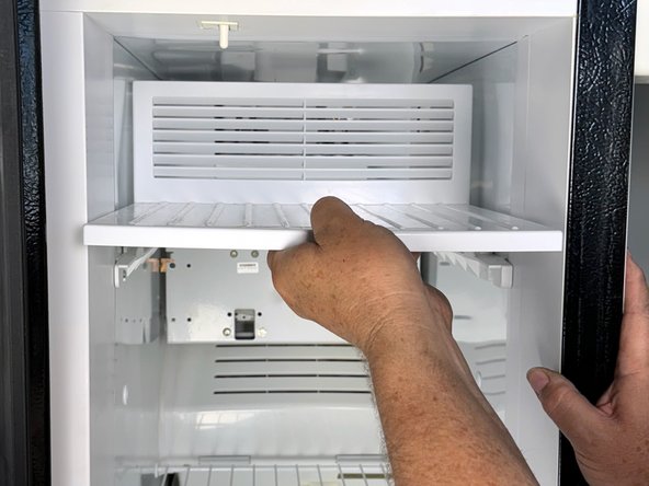

  2. GE Side-By-Side Refrigerator Ice Auger Motor Replacement, Remove ice bin: 手順 2、 3の画像 1 GE Side-By-Side Refrigerator Ice Auger Motor Replacement, Remove ice bin: 手順 2、 3の画像 2 GE Side-By-Side Refrigerator Ice Auger Motor Replacement, Remove ice bin: 手順 2、 3の画像 3
    • Grasp the ice bin and lift it upward slightly.
    • Pull the bin out of the freezer compartment and remove it.

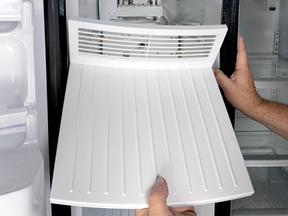

  3. GE Side-By-Side Refrigerator Ice Auger Motor Replacement, Remove ice maker cover: 手順 3、 3の画像 1 GE Side-By-Side Refrigerator Ice Auger Motor Replacement, Remove ice maker cover: 手順 3、 3の画像 2 GE Side-By-Side Refrigerator Ice Auger Motor Replacement, Remove ice maker cover: 手順 3、 3の画像 3
    • Lift the front edge of the cover 1cm (1/2") and pull the cover out of the freezer compartment.

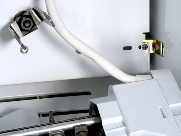

  7. GE Side-By-Side Refrigerator Ice Auger Motor Replacement, Disconnect ice maker: 手順 7、 3の画像 1 GE Side-By-Side Refrigerator Ice Auger Motor Replacement, Disconnect ice maker: 手順 7、 3の画像 2 GE Side-By-Side Refrigerator Ice Auger Motor Replacement, Disconnect ice maker: 手順 7、 3の画像 3
    • Disconnect ice maker plug by loosening the retainer clips by lifting them if possible and then pulling the plug out of the socket. The socket is shown with the plug removed.
    • This may take some force. You can try lifting the retainer clips with a small flat head screwdriver, but access is difficult.
    • Remove the ice maker from the freezer compartment.

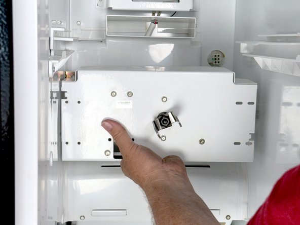

  8. GE Side-By-Side Refrigerator Ice Auger Motor Replacement, Unfasten the ice auger motor: 手順 8、 1の画像 1
    • Use a 1/4" nut driver to remove the two screws securing the ice auger motor to its support brackets.
  9. GE Side-By-Side Refrigerator Ice Auger Motor Replacement, Free the ice auger motor from its support brackets: 手順 9、 3の画像 1 GE Side-By-Side Refrigerator Ice Auger Motor Replacement, Free the ice auger motor from its support brackets: 手順 9、 3の画像 2 GE Side-By-Side Refrigerator Ice Auger Motor Replacement, Free the ice auger motor from its support brackets: 手順 9、 3の画像 3
    • Lift the ice auger motor to the right to free it from the left hand support bracket.
    • Lower the ice auger motor to the left, forward and down to allow it to clear the right hand support bracket.

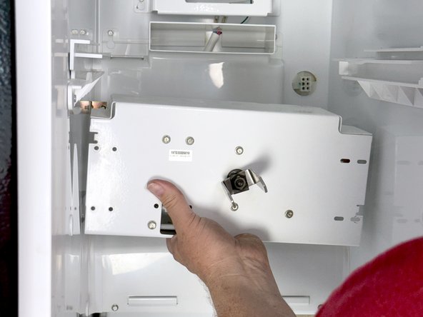

  10. GE Side-By-Side Refrigerator Ice Auger Motor Replacement, Reposition the ice auger motor assembly: 手順 10、 3の画像 1 GE Side-By-Side Refrigerator Ice Auger Motor Replacement, Reposition the ice auger motor assembly: 手順 10、 3の画像 2 GE Side-By-Side Refrigerator Ice Auger Motor Replacement, Reposition the ice auger motor assembly: 手順 10、 3の画像 3
    • Lower the auger motor assembly so that you can access the electrical connection.

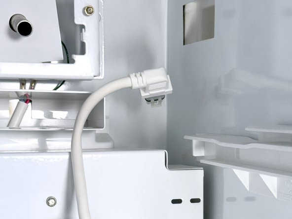

  11. GE Side-By-Side Refrigerator Ice Auger Motor Replacement, Disconnect and remove the ice auger motor assembly: 手順 11、 3の画像 1 GE Side-By-Side Refrigerator Ice Auger Motor Replacement, Disconnect and remove the ice auger motor assembly: 手順 11、 3の画像 2 GE Side-By-Side Refrigerator Ice Auger Motor Replacement, Disconnect and remove the ice auger motor assembly: 手順 11、 3の画像 3
    • The ice auger motor connection is mounted at an angle.
    • Squeeze the locking tabs on the connector to release it from the socket and pull it out to disconnect it.
    • Remove the ice auger motor assembly.
