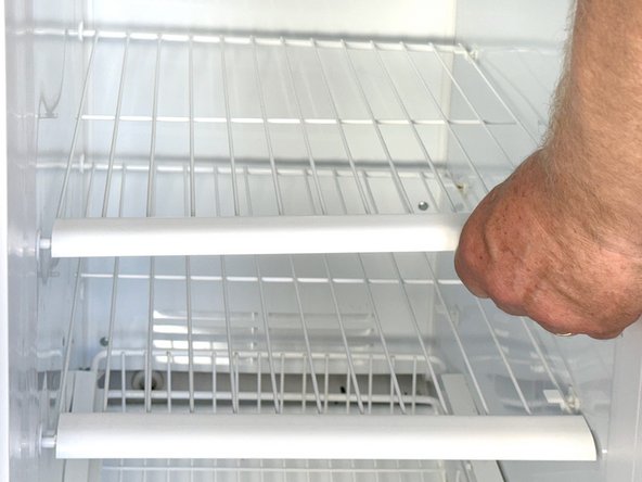

  2. GE Side-By-Side Refrigerator Freezer Thermistor Replacement, Remove shelves: 手順 2、 2の画像 1 GE Side-By-Side Refrigerator Freezer Thermistor Replacement, Remove shelves: 手順 2、 2の画像 2
    • Lift the right edge of the shelf to free it from the clips which secure it.
    • This may take a bit of force as the clips hold firmly
    • Once the shelf is lifted, move it to the right and free the tabs on the left edge.
    • Remove the shelf.
    • Repeat this for each of the freezer shelves.

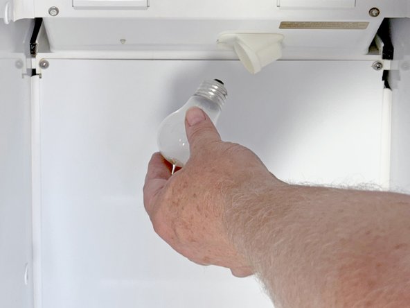

  3. GE Side-By-Side Refrigerator Freezer Thermistor Replacement, Remove the light bulb: 手順 3、 2の画像 1 GE Side-By-Side Refrigerator Freezer Thermistor Replacement, Remove the light bulb: 手順 3、 2の画像 2
    • Unscrew the light bulb and set it aside.
