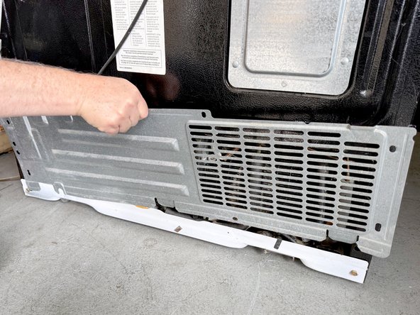

  2. GE Refrigerator Rear Access Cover Removal, Unfasten the rear access cover: 手順 2、 1の画像 1
    • Use a 1/4" nut driver to remove the screws securing the rear access cover.

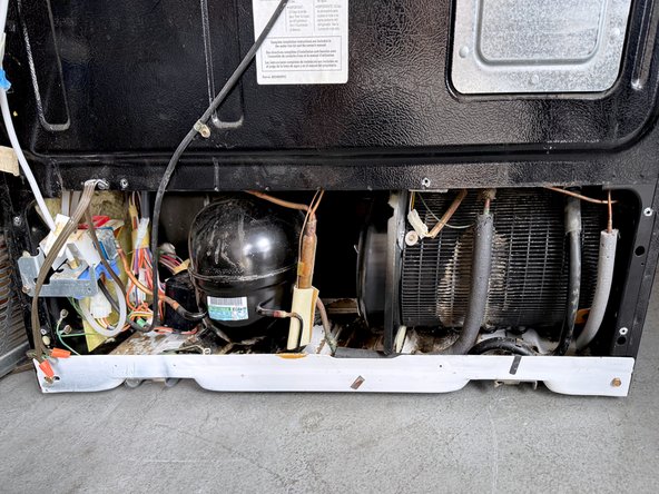

  3. GE Refrigerator Rear Access Cover Removal, Remove the rear access cover: 手順 3、 3の画像 1 GE Refrigerator Rear Access Cover Removal, Remove the rear access cover: 手順 3、 3の画像 2 GE Refrigerator Rear Access Cover Removal, Remove the rear access cover: 手順 3、 3の画像 3
    • Lift the rear access cover up and slightly outward
    • Remove the access cover.
