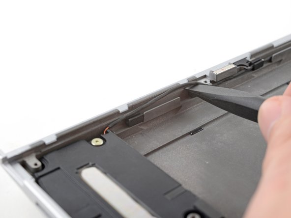

  15. Framework Laptop 16" Speakers Replacement, Unclip the speaker cable: 手順 15、 3の画像 1 Framework Laptop 16" Speakers Replacement, Unclip the speaker cable: 手順 15、 3の画像 2 Framework Laptop 16" Speakers Replacement, Unclip the speaker cable: 手順 15、 3の画像 3
    • The speaker cable is routed along the bottom edge of the laptop. The next three steps will demonstrate how to unclip it.
    • Starting at one speaker, use the flat end of a spudger, or your fingers, to lift the speaker cable out of its rubber clips.
  16. Framework Laptop 16" Speakers Replacement: 手順 16、 2の画像 1 Framework Laptop 16" Speakers Replacement: 手順 16、 2の画像 2
    • Slide the speaker cable out from under its screw hole peg in the frame.
  17. Framework Laptop 16" Speakers Replacement: 手順 17、 2の画像 1 Framework Laptop 16" Speakers Replacement: 手順 17、 2の画像 2
    • Repeat the last two steps across the length of the speaker cable until it's completely unclipped.
