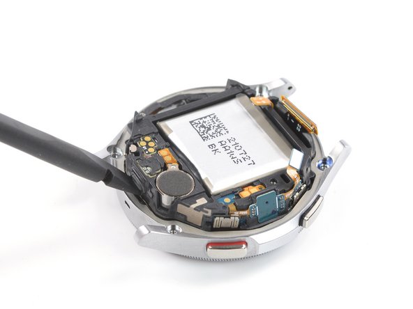

  11. Core Assembly Removal, Lift the core assembly: 手順 11、 3の画像 1 Core Assembly Removal, Lift the core assembly: 手順 11、 3の画像 2 Core Assembly Removal, Lift the core assembly: 手順 11、 3の画像 3
    • Place the corner of the flat end of a spudger in the small opening of the barometric sensor, on the opposite side of the display connector.
    • Twist and tilt the spudger to lever the core assembly out of the metal housing.
